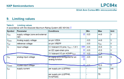

As ramprakash said that the ADC analog channel voltage ranges from GND to VDDA as the section 13.2 ADC in data sheet of LPC845
The limiting voltage for the analog channel pin ranges from -0.5V to 4.6V, if the analog voltage is outside of the range, the chip maybe damaged.

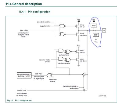

xiangjun_rong
As the following block diagram, I suppose that the ESD is implemented by diode, so if the pin voltage is out of the range from GND to 3.3V, the injection current will flow to VDD or GND from I/O pin, based on the spec of ESD diode, the maximum current is 2mA.

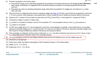

BTW, it is recommended to use external diode to protect analog I/O pin as the data sheet said:
