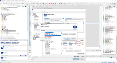

I am testing a custom board based on LCP54018J2MET180. I am trying to flash a simple helloworld program using MCUXpresso and MCU-Link pro as programmer. I have downloaded the SDK for the LPC54018J2, this device has an internal QSPI flash of 2M.
Whenever I try to flash the program I get stuck always on the flash drivver loading, since it doen't detect the flash from the device. I have tied IS0 and ISP1 high and ISP2 low so the system boots checking for the flash.
I have double checked that the lines regarding the SPIFI driver are not used in the board.
The output of the MCUXpresso is as follows:

luimarma
Hi Ron,
I didn't find a solution yet. I switched in the meantime to LPC54606J512 that uses normal internal flash rather than QSPI flash. I have lost some features but in the other hand I could probe that my original design was fully working. I will dig more on LCP54018 using Segger J-Link probe in SWD mode, since it is said to be compatible for LPC54018JMET180 but yest have to test.

luimarma
Already replaced with another LCP54018J2MET180.
I have also made a version of the same board but using LCP54608 that has on-chip flash, but not attached to SPIFI. With that one flashing works well, but not with LCP54018J2MET180.
With LCP54018J2MET180 I always get the following error.
Driver V.2 dynamic startup failed - driver Init provided no flash parameters
Flash Driver V.2 startup failed - rc Ef(55): Dynamic flash driver startup failed to provide flash parameters.
Terminate (0x0, 0x0, 0x0) status 0x40 - driver reports init failure - EXTSPI driver rc 13 - No supported SPIFI device found
chip initialization failed - Ef(55): Dynamic flash driver startup failed to provide flash parameters.
failed to initialize flash driver LPC540xx_SPIFI_GENERIC.cfx
I have checked in the documentation and LCP54018J2MET180 has internally a flash marked as Winbond W25Q32JV. The LPC540xx_SPIFI_GENERIC.cfx has support for W25Q32FV chip, but it looks that they share the same ID codes. I tried to recompile the driver setting the size of the W25Q32FV to 2Mb but still no success, the chip cannot be programmed.
Can anyone help here? How is it possible there is no way to program the internal Flash?
Where's my mistake?

xiangjun_rong
Pls try to select the flash driver LPC540xx_SPIFI_GENERIC.cfx and have a try.
If it does not work, I suppose it is complex, you have to check the user manual of your own spifi flash on custom board, and develop the driver yourself.

luimarma
The spifi flash is not a custom one, it is the internal spifi flash of LCP54018J2MET180.
Using LPC540xx_SPIFI_GENERIC.cfx driver doesn't help also.
