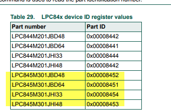

In the user manual the ISP part identification number of LPC844M201JHI48 is specified as 0x00008442, the same as for LPC844M201JBD48.  From looking at the LPC845 codes I guess the correct number is 0x00008443, is that right?
The context is that I'm just updating lpc21isp for the new LPC84x parts.

Any news on what the correct part id for LPC844M201JHI48 is?

The corrected table29

The User Manual Table 29 still need to be corrected.

Table 29 in user manual, shows the LPC84x device ID register values:
I hope this helps,
Sol

The problem is that this table shows identical part ids for two different devices, so it can't be correct.
