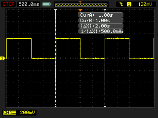

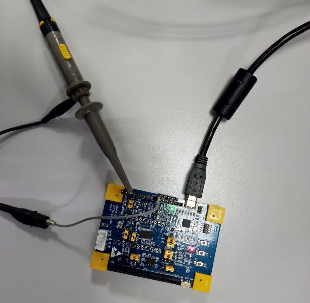

Hi Kurt Mirdell,
Thank you for your reply.
I've used the lpcxpresso804_led_blinky demo which is from the SDK library as the template, and do a bit modification to make the PIO0_4  toggles per 1 second.
It works well, please check the attachment and give a try.
