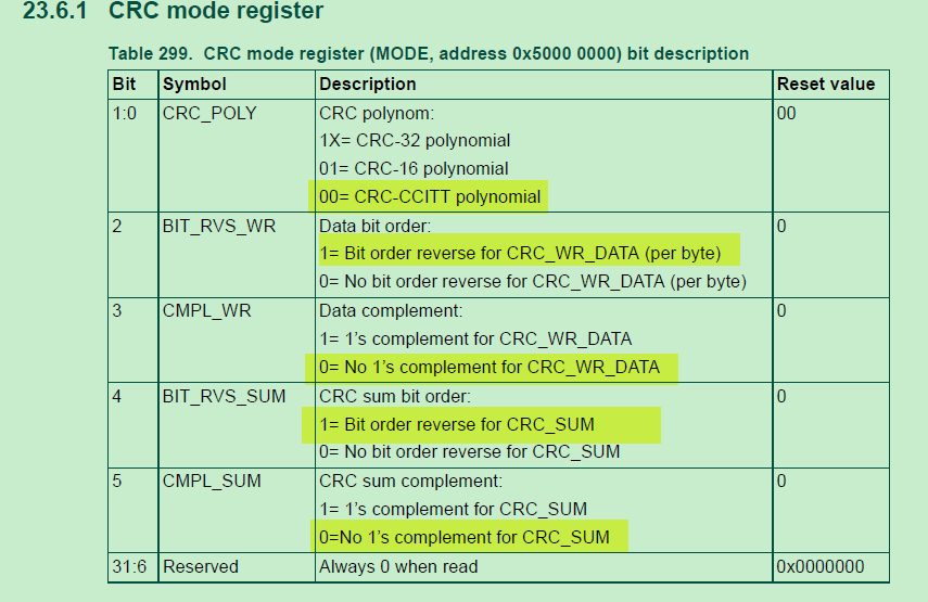

1.  Your desired information
Polynomial = x16 + x12 + x5 + 1   (ccitt)
Seed Value = 0xFFFF
Bit order reverse for data input: Yes
1's complement for data input: NO
Bit order reverse for CRC sum: Yes
1's complement for CRC sum: NO
According to the register description
So, MODE should be:0x14 .

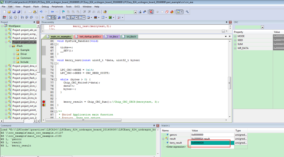

2. function
static const uint8_t kerrytest[] = {0x41,0x42,0x43};
uint32_t kerry_result;
In main, call:
int main(void)
    /* Board Initialization */
    SystemCoreClockUpdate();
    Board_Init();
    /* Chip Initialization */
    Chip_CRC_Init();
    /* Enable SysTick Timer */
    SysTick_Config(SystemCoreClock / TICKRATE_HZ);
    /* Loop tests with occasional forced error */
    while (1) {
      kerry_test(kerrytest,3);
void kerry_test(const uint8_t *data, uint32_t bytes)
    LPC_CRC->MODE = 0x14;
    LPC_CRC->SEED = CRC_SEED_CCITT;
    while (bytes > 0) {
        Chip_CRC_Write8(*data);
        data++;
        bytes--;
      kerry_result = Chip_CRC_Sum();//Chip_CRC_CRC8(kerrytest, 3);
After test, the debug result is:
You can find the kerry_result is 0x60d0 .

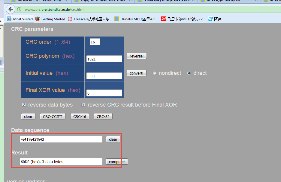

3. Use CRC calculation tool
CRC calculation
In conclusion, you can find the result in  CRC calculation tool and the LPC824 code is the same.
