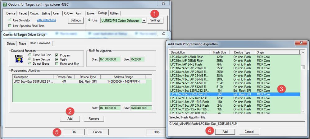

Lpc4330 has no in-chip flash, how do you burn the program to the outside flash through jtag under keil?

You can program the external flash via the the general process as the Fig 1 illustrates.
Fig 1
