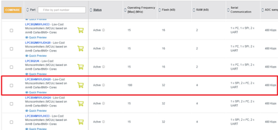

I found out that there is a part in the LPC80X family that can run up to 180MHz.
Is this true or just a typo?
Other families have similar special products. LPC832M101FDH20.

This was a typo and it's fixed.
Please check again.
Thanks for bringing the problem to our attention.

I suspect this is just a typo.
Especially considering the very similiar devices listed below this entry, which all specify 15MHz.
AFAIK, ARM's licence conditions don't allow for freestanding M0/M0+ with clock rates beyond 50MHz.
