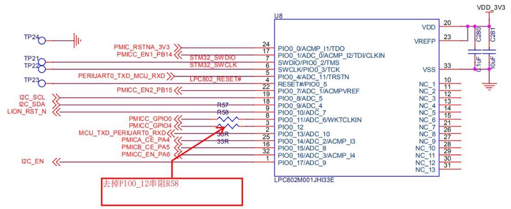

We are in the debugging LPC802.
There is a probability that the reset pin will not pull up when restarting.
Please tell me how to solve it. Thanks.
Reset Pin SCH:
LPC802 SCH
Power & Reset

Hi ,
for the opportunity to serve you.
After having a brief review of the schematic, I don't find anything wrong with it, so I'd like to know what the ratio of boards encounters this phenomenon, I suspect that the phenomenon may be related to PCB manufacturing or soldering technique.

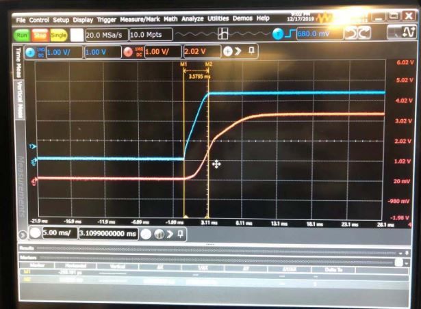

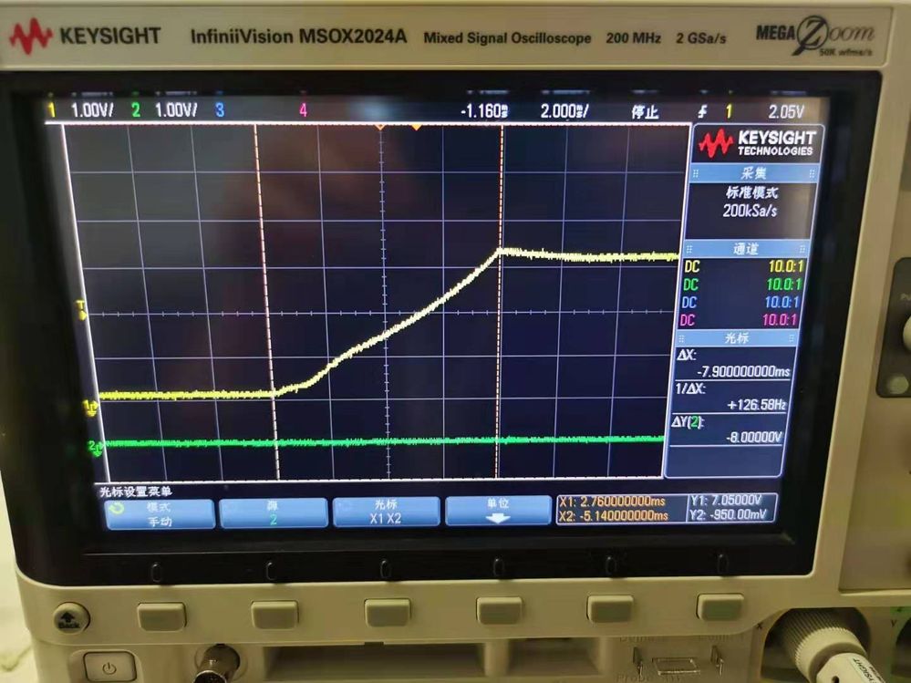

"There is a probability that the reset pin will not pull up when restarting."
Actual testing :
1、This is abnormal LPC802's PCB can be restarting on the computer.     Use 3.3v start-up time 2ms.
2、This is abnormal LPC802's PCB cann't be restarting on the customer device.   Use 3.3v start-up time 8ms.
Could you tell me special requirement for LPC802 start-up ?
On the computer start up:

On the customer device start up:

jeremyzhou
Hi ,
Thanks for your reply.
Regarding the phenomenon, you should check the hardware design, especially the power supply, external crystal, reset pin, they're essential components of the minimum system.
