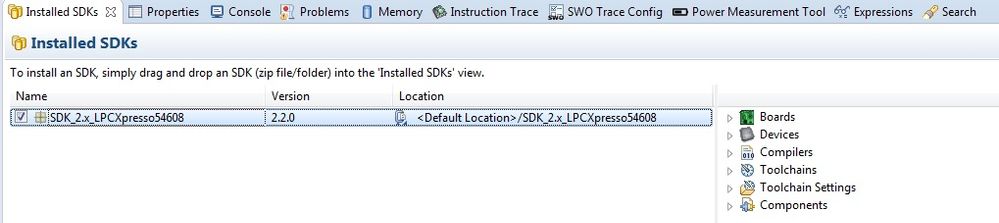

The 1st thing is to add LPCXpresso54608 SDK into MCUXpresso IDE by simply dragging the zip file into SDK tab
After the installation the SDK packages will be show in the editor like below

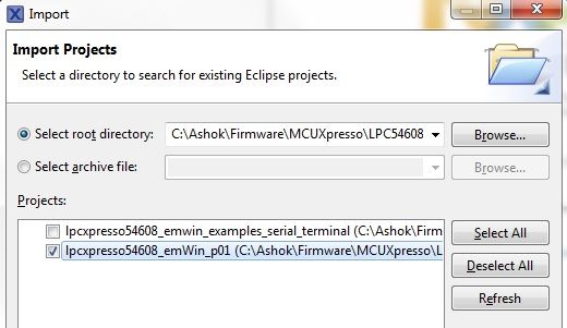

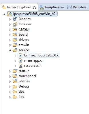

next step Import the example project attached in this post,
one import is done, the project files will be show in the project explorer
It has board files,drivers, emwin lib's and utilities etc,

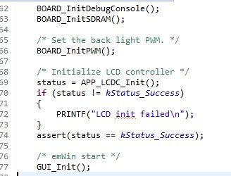

In main_app.c Clock ,Board and LCD initialization are done before initialization the emWin lib (GUI_Init())
then clearing the screen and setting the background color using emWin prototypes.

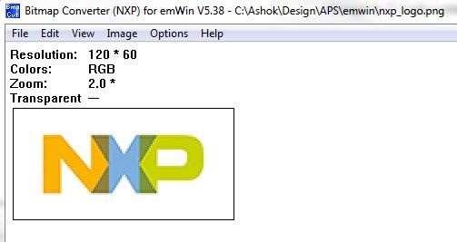

First step you need to create image data (hex data) from pictures.

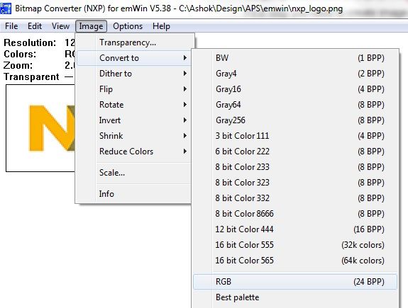

Run BmpCvtNXP.exe and open the image , i used 120x60 sized png file
in the next step convert this image to BPP 24bit format . you have many option here to convert into different formats

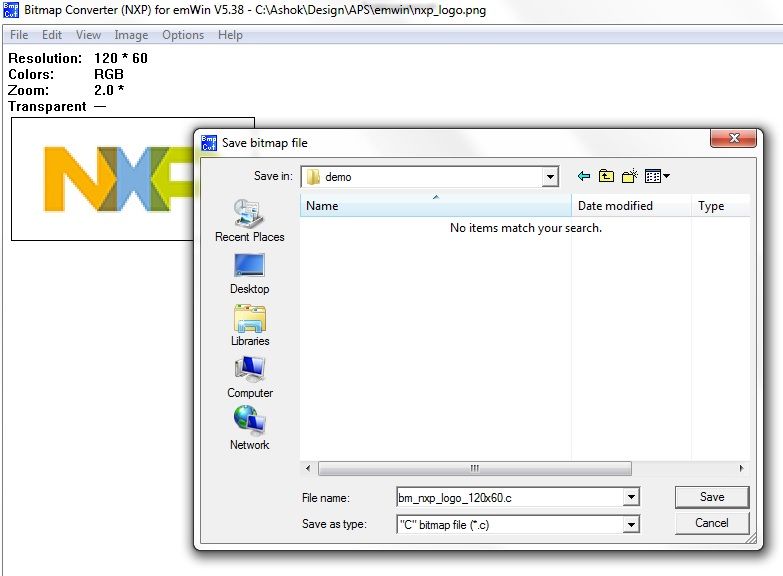

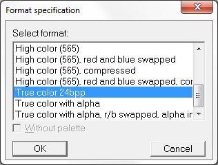

in the next step File->Save as Bitmap ".c" file
and now the promotion box will be displayed to choose the format , select true color 24bpp and give ok.
The C file will be generated and add to the project ,you can give rename the file/variable if required.

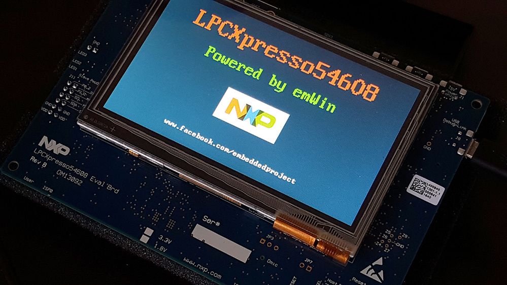

finally run compile the code and flash the firmware through on-board debugging.
and now your creation will be displayed on the LCD screen.
