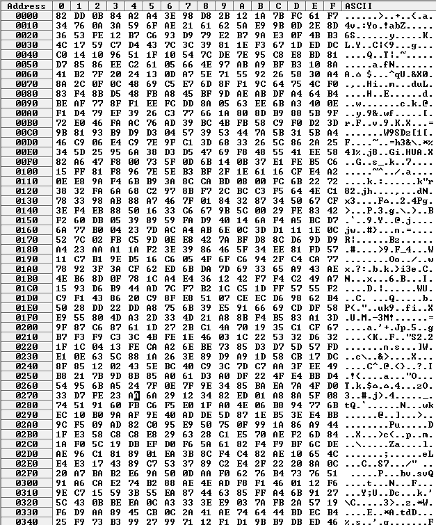

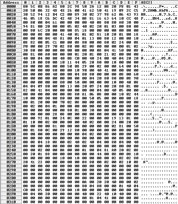

Hello all,
I have a problem when i try to erase Flash memory of LPC802M001J (currently I use the LPCXpresso802 board OM40000 Rev A)
My step are these (with SWD protocol):
1-> I Read the SYSMEMREMAP register and i found the value 0x02.
2-> I write into the same register the value 0x02.
3-> I send a Kernel into Ram at position 0x10000000. This Kernel is built with MCUXpresso IDE.
4-> I send the IAP command from my driver to uKernel. Into Kernel I send the IAP command to the ROM and then I await the response of the IAP.
5-> When I send the IAP command for Read Part ID, Read UID or Read Boot Code Version, all works well. So IAP responds correctly. The same for Blankcheck command.
Problem:
When I send the Erase Sector command (command code 53), IAP responds with OK (
obviously before this command I prepare the sectors for erase with command 50).
But after that command the Flash memory is not blank, only some bits are brought to the blank state.
You can see the status of the memory in the following images.
Before Erase:
After Erase:
Any help is appreciated.
Thanks.

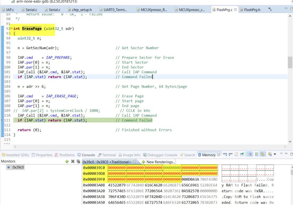

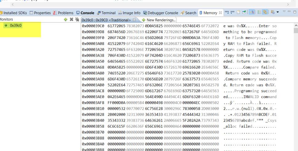

Hello MOreno,
Just want to know have you test the IAP_test demo on your board? Dose the Erase function works well?
I test it on my side, it can work well, I change some code, erase the sector 14 page 7 (ox39c0):
Before erase:
After:
You can use the erase driver in this demo, if still can't work, please send your project to me.

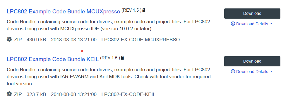

Hello moreno ortolan,
As Johan mentioned, command code 52 is erase .
How about your code? I recommend you first test the demo code:
LPCXpresso802 board for LPC802 Microcontroller (MCU) | NXP
After download , you can find "IAP_test" demo, it includes erase function.
TIC

Hello MOreno,
Before erase:
After:
