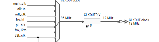

LPC51u68 project PLL question. We are using USB interface and need to generate PLL generated signal to drive external IC on its osc in. We need a frequency range from 9MHz - ~ 14 MHz with a resolution of approx 50KHz. (42-60KHz). Is this possible without influencing USB communication. Data sheet not entirely clear in this respect. We think it shall work but need coinfirmation or hints if this is possible or if we need to employ an external PLL for that purpose. Many thanks Michael

Hi Michael
Yes, you can output pll clock to CLKOUT
for example, if your pll clock is 98Mhz, CLKOUT=pll_clk/8=12M. 12M is for output. It won't affect USB clock.

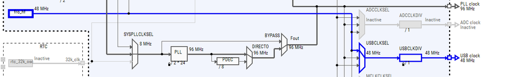

ZhangJennie
Hi Michael
You can also use FRO_HF as USB clock source. it can be configured to adjust automatically to the USB bus rate.
it can work with full speed usb without issue.
Call the FRO high frequency output setup API. for selecting 48MHz or 96 MHz with trim. see USB clock config path in blue
Best Regards
Jun Zhang
