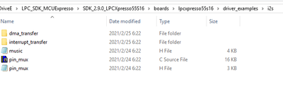

Regarding the DMA plus I2S, in SDK package, there is example
This is the SDK link:
https://www.nxp.com/design/software/development-software/mcuxpresso-software-and-tools-/mcuxpresso-s...
Hope it can help you
