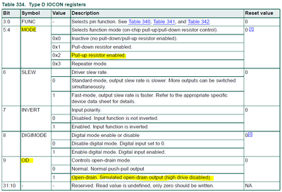

Hi community,
Is it legal to config type D pin as open drain with pull-up mode?
Is there any adverse impact?
Best Regards.

I suppose that the on-chip pull-up resistor is very large,the typical value is about 50K ohm, so the driving capability is small.
So external pull-up resistor with several K ohm for the open-drain pins is recommended.
Hope it can help you
