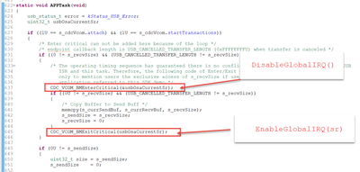

I am using the LPC5528 microcontroller for an audio application that requires sampling digital inputs at 100 kHz and processing them in real time. To sample the signal, I am using a timer that generates a trigger for the analog-to-digital converter. The application also includes a USB VCOM connection to a PC. However, as soon as I connect the computer via USB, many samples are lost, even though the USB interrupt has a low priority.
Analyzing the code, it seems that the USB handling routines disable all interrupts to protect critical sections of the code.
How can I solve this problem?

I have done some tests using the LPC55S28 development board. I think the "lpcxpresso55s28_dev_cdc_vcom_bm" program in this SDK is more suitable for your application needs. You can refer to this demo, but the vcom routine in this program is self-transmitting and self-receiving (echo), and the data received by the virtual serial port is sent back intact. Therefore, when using this demo, it is necessary to decouple VCOM's Tx (transmit) and Rx (receive).
As you said, in this demo program, when the device receives data from the PC (host), it will disable all interrupts to protect the Copy Buffer to Send Buff code from interrupt interference. Please make sure that you have avoided the host from sending data to the device during the sampling process, or removed these codes.

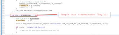

At the same time, you can set the sampling flag in the position shown in the figure below to transmit data from the device to the host.

Thank you for your reply.
Following your suggestion, I've separated the USB data transmission and reception routines and eliminated the function calls that disable and enable interrupts, but the issue persists.
Could there be other function calls within the USB driver that disable interrupts?
