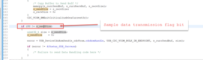

As you said, in this demo program, when the device receives data from the PC (host), it will disable all interrupts to protect the Copy Buffer to Send Buff code from interrupt interference. Please make sure that you have avoided the host from sending data to the device during the sampling process, or removed these codes.
At the same time, you can set the sampling flag in the position shown in the figure below to transmit data from the device to the host.
Wish it helps you.
