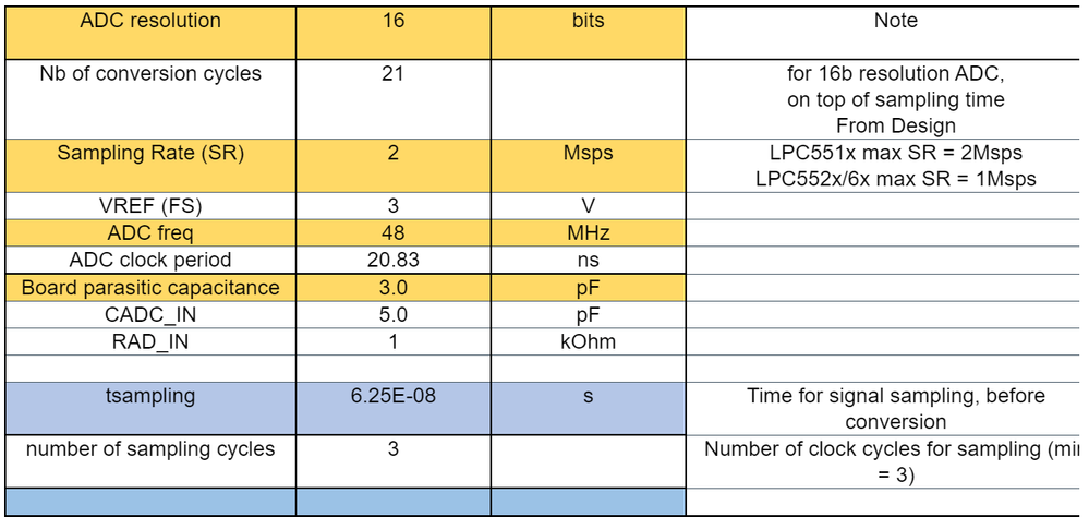

Dears,
  As we known, LPC55XX ADC sample ratw is 2MHz, can I know the ADC convertion time?
Thanks & BRs,
Ray

   The P/N is LPC5512JBD100
    It is used for Environment Detecting Device, which require 16-bit ADC.

ADC conversion time should include  sample time and actual conversion time.
please refer below table,
sampling time is tsampling. conversion time is conversion cycles * ADC clock period

Hi Jun Zhang,
According to your table, does LPC5528 support 48MHz adc clock frequency?

Francis,
24MHz is for LPC55S2x/6x,  the ADC sample rate is 1Msps.
48MHz is for LPC55S1x,       the ADC sample rate is 2Msps.

Hi Jun Zhang,
  I would like to know if tsampling can be 62.5nS even for 16-bit resolution.
 Ari

yes
