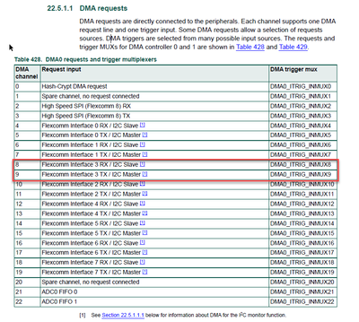

Hello @AveryDauben,
The DMA has a separate DMA request for each Flexcomm, as shown in the following image:
If you wish to modify the Flexcomm, it is essential to modify these channels. For example, channels 18 and 19 correspond to the Flexcomm 7 interface, which is why the macros are defined as follows:
#define EXAMPLE_SPI_MASTER_RX_CHANNEL 18
#define EXAMPLE_SPI_MASTER_TX_CHANNEL 19
Also, if you experience any issue, does not hesitate to let me know.
Habib.

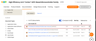

AveryDauben
@Habib_MS
could you please attach the file that you are looking at? The Dual-DMA usage pdf on the LPC55S6x page is not fully up-to-date. Thank you!
2,942件の閲覧回数
Habib_MS
Hello @AveryDauben,
The table was taken from the user manual, which you can find on this page:
Habib.

AveryDauben
Thank you, this fixed the issue. I must've had an outdated version of the DMA channels as FlexComm 2 and 3 aren't switched on this pdf.
