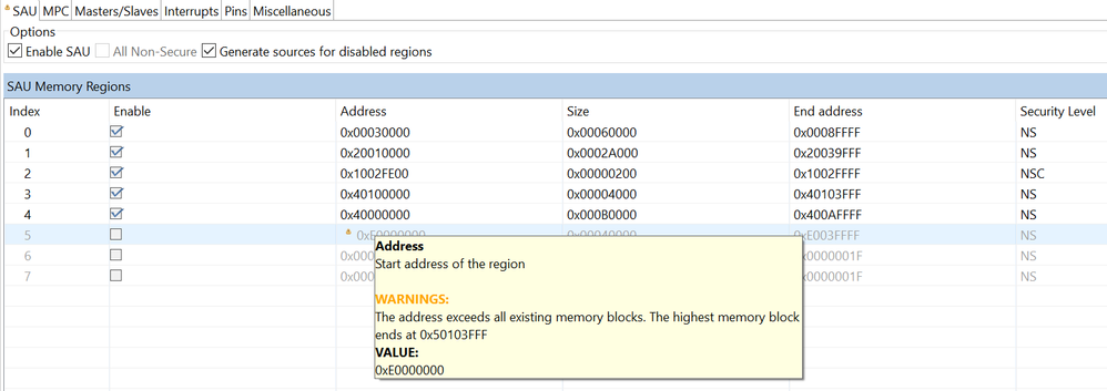

I would like to simplify memory attributes configuration and decide to disable IDAU. Looks like it is redundant in common cases.
Do I understand right and in case of SAU I should specify only NS and NSC memory regions only ( non-secure memory address range are in use) ? Other parts remain secure by default.
I have added non-secure flash and sram , peripheral area and PPB area ( 0xE0000000 - 0xE003FFFF (256KB)).
After that MSW,MPC/PPC setting refine final access attributes.
Looks like I should specify peripheral area in SAU, because PPC can't enable peripheral usage on nonsecure side.
But PPB area definition in SAU looks like redundant and on user side in privileged mode I can enable/disable interrupts for example. Is any idea why PPB area looks out of "SAU" control ?
ConfigTool is even complains about PPB address range :
Issue: The address exceeds all existing memory blocks. The highest memory block ends at 0x50103FFF
Level: Warning
Type: Tool problem
Tool: TEE
Origin: TEE
Resource: SAU Memory Region at Index 5
Information: The address exceeds all existing memory blocks. The highest memory block ends at 0x50103FFF
Eugene

If you don't enable the region in "SAU memory regions", the default security is S. see below screenshot
If you enable it, you can only configure it as NS or NSC
Regarding to your other question "why PPB area looks out of "SAU" control ?", Can you please send me step by step screenshots or a video of how to reproduce this issue? I will check.

Try to add 0xE0000000 - 0xE003FFFF area to SAU configuration. It should be accessible from non-secure side as well. But not provisioned.
I also disable IDAU.
So even this area is not provisioned, everything works fine. Looks like PPC area is always accessible on non-secure side.
MPU is also configured in my case. But PPB area covered by default setting of it. E,g access enabled in privileged mode.
Eugene

Looks like adding 0xE0000000 - 0xE003FFFF area to SAU configuration is block secure side for some accesses and
Entering HardFault interrupt!
Another secure bus error.
Happens some time. For example when I read all MPU_S registers for see what is current configuration.
I assume that PPB area has special rules and accessible on secure and non-secure side even SAU keep it secure by default.
And IDAU is disabled.
But from UM this rule is not clear.
Is any idea what can be default access rule for PPB area ?
Eugene

This is natural ARM PPB area.
And it is mentioned as well in UM :"Fig 172. Security attribute definition as combination of SAU and IDAU"
In my case IDAU is disabled and in non-secure side this area accessible in privileged mode without any problem
even it is not mentioned in SAU.
Looks like some how configured somewhere deafult access to it on nonprivileged side.
And would be nice to know if this is expected.
Eugene

Now I'm not add any PPB area configuration to SAU tab.
But PPB area of nonsecure side can be added to it and ConfigTool generate code.
SAU tab generate warning only and do not have any hard protection.
I can see generated code in tzm_config.c
#define REGION_5_BASE 0xE0000000U
#define REGION_5_END 0xE003FFFFU
/* Set SAU region number */
SAU->RNR = 0x00000005U;
/* Region base address */
SAU->RBAR = REGION_5_BASE & SAU_RBAR_BADDR_Msk;
/* Region end address */
SAU->RLAR = ((REGION_5_END & SAU_RLAR_LADDR_Msk) | ((0U << SAU_RLAR_NSC_Pos) & SAU_RLAR_NSC_Msk)) | ((1U << SAU_RLAR_ENABLE_Pos) & SAU_RLAR_ENABLE_Msk);
But if I specify this area as NS, I have quite often fault like this :
SCB->BFSR:PRECISERR fault: Precise data access error.
Address that caused secure bus violation is 0xE000ED90.
I have got conclusions that PPB area is always accessible on non-secure side by default.
If it configured in SAU, it cause some problem for Secure side what also can access this area using  non-secure address range.
But in any case those rules are not mentioned anywhere.
Why non-secure side has default access to PPB ?
Eugene

You can see 5th region is not enabled but I enable it for testing purposes.
But it might be so that it is hidden and no require any provisioning.
But it should be specified somewhere.
Eugene

0xe00000000-0xefffffff, by default SAU set it as secure. IDAU set it non secure. so overall, default is secure.
If you don't check region5, it's secure feature. So with this default setting, there is no error.
if you enable region5, set this region as non secure, you got HardFault error. Is this your problem?
5,654件の閲覧回数
EugeneHiihtaja
Senior Contributor I
Hi ZhangJennie‌ !
IDAU is disabled in my case.
Yes, if I enable region5 HardFault happens .
But non-secure part is able to access PPB even it is non-secure by default.
How possible to explain this phenomena ?

I think it is more important to find out why PPB area is not provisioned at all.
All your SDK examples doesn't have it in SAU configuration.
Can you say if LPC grant access to PPB area automatically for non-secure side ?
Even IDAU is disabled. So this is not error , it is expected.
Eugene
5,654件の閲覧回数
ZhangJennie
By checking, PPB area includes ARM core registers. it can only be accessed with default secure setting. Please don't set it NS.
