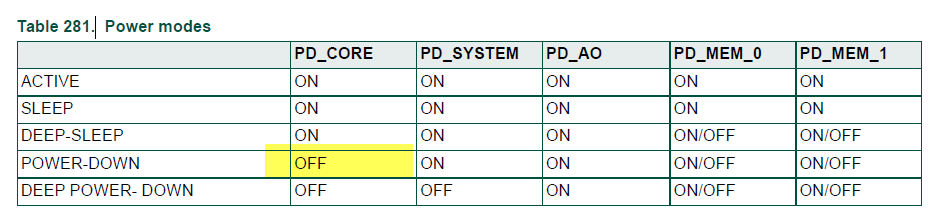

EugeneHiihtaja
Senior Contributor I
Hi ZhangJennie‌ !
It is not enough for sure.
If I enable clock and read major registers they all 0.
PUF VERSION 0x00000000
PUF STAT 0x00000000, ALLOW 0x00000000, PWRCTRL 0x00000000
After full reinitialization there are back and PUF ready for Key Set/Get operations:
PUF VERSION 0x18A70101
PUF STAT 0x00000002, ALLOW 0x0000000C, PWRCTRL 0x00000003
I try to skip RESET for example. Nothing helps.
Only PUF_Init and PUF Start after that.
I have enrolled PUF via ISP and secure boot and etc is not used yet.
But I should know fast recover sequence after PowerDown mode what dosn't cause any impact for standard intrinsic keys.
I think a lot of peoples might have similar use case.
Eugene

ZhangJennie
Hi Eugene
According to Table 280. Power domain supply, Physically Unclonable Function (PUF) is under PD_CORE power domains. According to Table 281. During power down mode, PD_CORE is OFF. Thus we can conclude PUF is off during power down mode. Thus we need reinitialize it after wake-up.
PUF keys for AES and PRINCE, if already loaded, are retained during deep-sleep and power-down, but PUF itself is off during power down mode.
Jun Zhang

EugeneHiihtaja
Hi ZhangJennie‌ !
I think if "PUF keys for AES and PRINCE retained" somewhere, it is not a problem to reinitialize it when PUF is need for user keys.
But 2 problems appears.
Initialization of PUF might take up to 400 ms in worst ambient conditions what are not specified so well.
I can see it take quite short time and if it can take so long it can be problem.
How properly to identify if PUF is not initialized yet ?
I think I can read register as usually, but may be enabling of PUF clock is need as well.
Is this so ?
CLOCK_EnableClock(kCLOCK_Puf);
if (!PUF_IsGetKeyAllowed(PUF))
// Full PUF reinitialization
Eugene
3,604 Views
ZhangJennie
As we must reinitialize it after wake-up from power down, you just need initialize it directly.
It's also ok to reinitialize PUF as your code.
