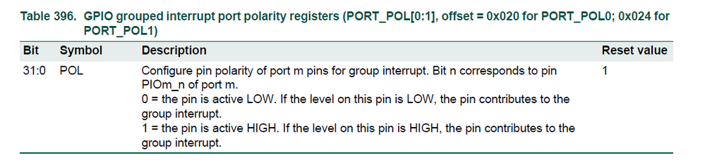

Do I understand right and any GPIO pin from group 0 or 1 can be included to GINT0 or 1.
So the same pin can't be in both GINTx but it port 0 pins can be part of GINT1 and vise versa.
Is this so.
But if I select edge sensitivity of all pins what are part of GINT0 group, can I select falling edge or rising edge
for each pin individually or for all of them ?
Eugene
2,250 Views
Hello Eugene Hiihtaja,
" any GPIO pin from group 0 or 1 can be included to GINT0 or 1."
-> Yes, any pins from PORT0 and PORT1 can be included to GINT0 and 1.
" the same pin can't be in both GINTx but it port 0 pins can be part of GINT1 and vise versa."
-> I think the same pin can be in both GINT0 and 1.
-> Yes, you can config them individually. The PORT_POL register can config each pin polarity:

EugeneHiihtaja
Senior Contributor I
Hello Alice !
It means I should include pin to both group if I would like to detect both edges.
Is this so ?
Eugene
2,250 Views
YES.
