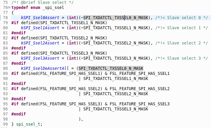

Hi, a couple of month ago I've had a lot of 'fun' to understand the meaning of 'assert' and 'deassert' of TXSSEL in the documentation. I thought I got it.
But now I returned to a SPI project and have a question:
Shouldn't kSPI_SselDeAssertAll has the value 0xF0000U instead of 0x10000U? Below it has the same (inverted) value like kSPI_Ssel0Assert, but to deassert all I would expect a '1' to SSEL0-SSEL3.
But may be it's to late tonight...

Yes, the kSPI_SselDeAssertAll should be 0xF0000.
Thank you for pointing it out.
