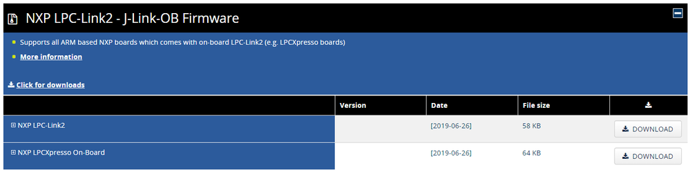

On the Getting Started with LPC-Link 2 page it mentions that we have to manually update the binary on the following folders located in the PC:
  • To make sure that LPCscrypt uses the latest LPC-Link2 firmware, please replace the J-Link firmware images located in:
  • LPCScrypt_InstallDir\probe_firmware\LPCXpressoV2\ and
  • LPCScrypt_InstallDir\probe_firmware\LPCLink2\
I have downloaded the NXP Link 2 Jlink OB Firmware the second option that is the LPCXPresso On Board.
Once I updated the binary from the LPCScrypt, I put the board in DFU mode and selected "program_JLINK".
I then deleted the debug sessions from the example and pressed the debug icon again. I compared the memory configuration from both debug sessions and it is resulting in the same configuration for the veneer table.
Can you please confirm if you have done the same steps to update with the Segger J-Link?

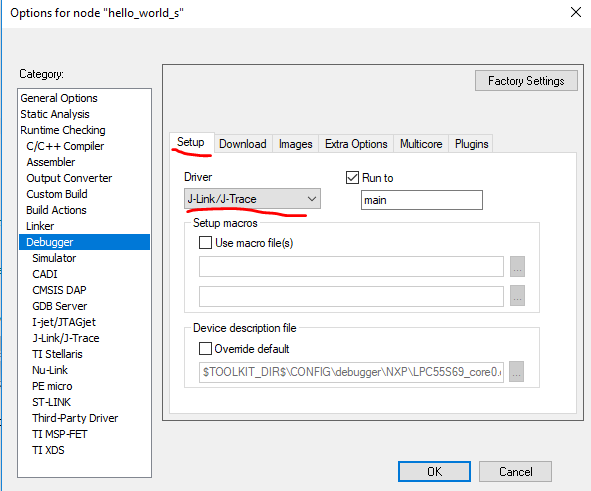

Sabina_Bruce
Hi Simon,
Sorry for delayed response. I have new information on what may be gonig on here.
Could you please make sure that this checkbox is not selecteded.
And also this driver is chosen.
Please try this as with the testing with this the first binary is not getting erased.
Let me know if this works for you.
Best Regards.
