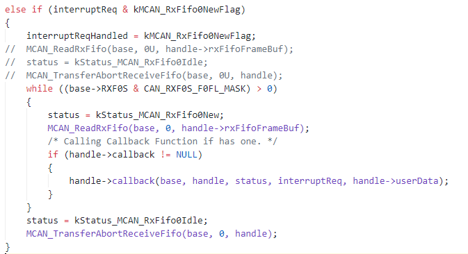

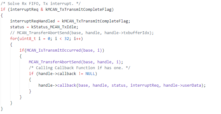

teus
We have an issue that is very simular to this one. What is looks like is that we are missing Tx interrupts in the same handler.
This results in a crash in the fsl_mcan which can only be recoverd by setting TXBAR register to 1. Then it runs for a while and it stops sending CAN messages again.
We are working with a LPC54608.

teus
We did not measure any difference. Maybe it is because we already have the following construction in the Rx handler.
The above code solves a lot of trouble with the receiving part of the driver. But now (a few months later) the transmitting part is giving trouble.
We added a simular construction to the Tx handling:
This construction takes on a fraction longer but also crashes after a while.

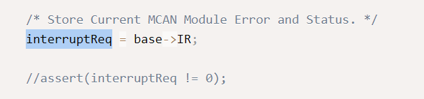

teus
We also see after some testing that the handler is called and the interruptReq stays zero. The same scenario Tomas captured in the  assert.
But if we place a breakpoint after the copy we see that the IR register contains some interrupts.
5,506 Views
tomasxvavra
Yes, this is another issue I have been also investigating but didn't found anything.. Iterrupt handler is called and IR register is zero, I have no idea how could this be happening.
