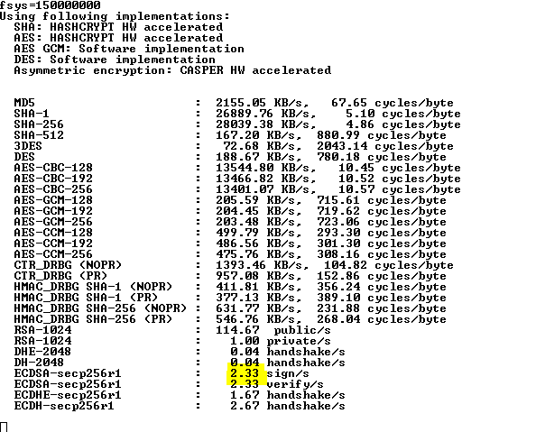

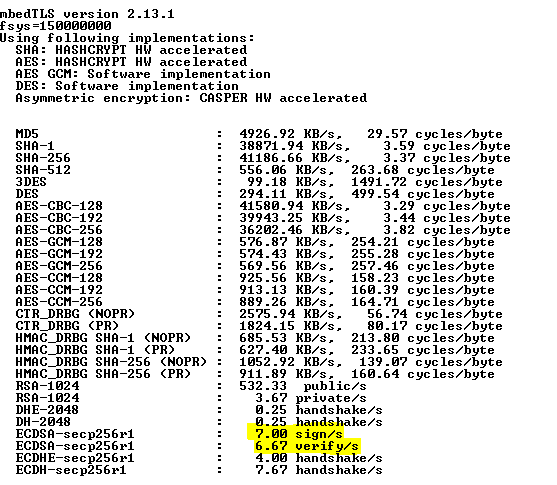

Hope you are well. First I'd like to confirm the microcontroller version that you are using, as well as your SDK version as I notice that your fsys=96MHz, this indicates that either one may be an older version.
In addition, I'd recommend that when testing the benchmark example, you use the release build instead of the debug build to optimize it.
In my test I am using MCUXpresso 11.1.0, SDK version 2.6.3, LPCXpresso 55S69 Revision A2(1B silicone).Here are my results(Release Build):
Same test but (Debug Build):
Let me know if this helps you.
