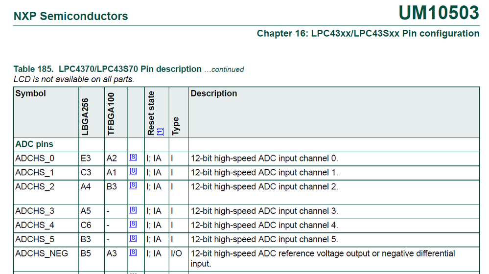

How to program GPIO pins to accept a signal from the signal generator and sample it using HSADC of LPC-Link2 board(LPC 4370) in LPCXpresso

Also, can I get the program for configuring the GPIO pins as input and output of LPC-Link2 board with LPC 4370 microcontroller.

Hi, Naveen,
This is the figure the ADCHS analog input pins, as you can see that the ADCHS analog input pins are independent analog pins, they are not multiplexed with the GPIO or any other peripherals, so you do not need to configure anything for the ADCHS analog pins.
Mr Bernhard has attached the example package,pls check it.
