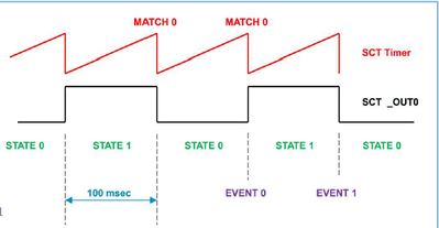

So here is the problem, I would like to create a blinky match using SCT in LPC55S69. So I started with the demo blinky match project that you could get from the Board Support Pack. However the demo does not uses SCT. After referring the SCT_Timer_Cookbook, I tried my best to create a new project by combining the SCT blinky match coding from the cookbook and the blinky match from the demo.
But since my knowledge in embedded programming and SCT is barely enough, I failed to make the LED on the LPC55S69 board to blink. However it did light up, just not blinking.
So based on the SCT figure above, my understanding is that when in State 1/Event 0, the led will turn ON, and in State 0/Event 1 the LED will turn OFF. So that will create the blinking effect. But I am not sure how the state/event commands the LED to turn ON or OFF.

1. Does the "SCT0->OUT[0].CLR/SET" actually turns the led on or off ? I also have some doubt that "OUT[0]" is the same as PORT1_4.
2. Is there anything more that I need to add ? I feel like there is something missing. I know that the SCT basically have Event 0 and 1. but how do I let it know that if Event 1 happens then this happens ? Feels like I set an event but does not set what happens to it.

Hi, Jalal,
I think the code sct_init() is okay.
For your issue that you can not see the LED toggles, as you know that LED toggles at 10Hz, it is too fast to see the LED toggle.
Pls try to use the code:
LPC_SCT->MATCHREL[0].U = (SystemCoreClock/2)-1; // match 0 @ 2 Hz = 100 msec
I suggest you connect the P1_4 pin to a scope so that you can see the waveform.
If you still can not see the LED toggle, I suppose the pin configuration has error.

jalal-san
OMG! Thank you so much !
That really fixed the problem.
You are right, turns out the pin configuration has error.
Your code helped me fixed it.
