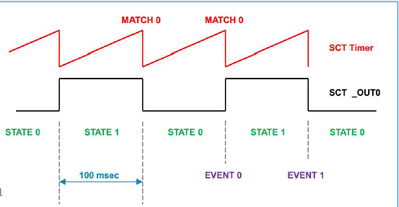

So based on the SCT figure above, my understanding is that when in State 1/Event 0, the led will turn ON, and in State 0/Event 1 the LED will turn OFF. So that will create the blinking effect. But I am not sure how the state/event commands the LED to turn ON or OFF.

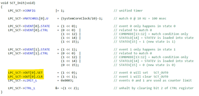

Firstly, I copied this code from the SCT cookbook into my blinky match demo, I guess that maybe the highlighted part will turn the LED ON or OFF, since PORT1_4 uses SCT_OUT0 in the datasheet.

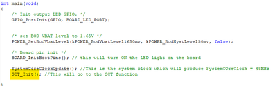

Then, in the main function, I included the SCT_Init() function. I modify the previous blinky match demo by deleting the systick timer which adds 100ms delay and PortToggle function which turns off the LED.

1. Does the "SCT0->OUT[0].CLR/SET" actually turns the led on or off ? I also have some doubt that "OUT[0]" is the same as PORT1_4.
2. Is there anything more that I need to add ? I feel like there is something missing. I know that the SCT basically have Event 0 and 1. but how do I let it know that if Event 1 happens then this happens ? Feels like I set an event but does not set what happens to it.
