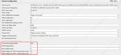

     I am testing the ADC0 with DMA request function for LPC55S69, but still can't get the DMA interrupt.
    Can you help to check ?
    Thanks very much.
    1>Hardware: LPC55S69-EVK
    2>SDK:  2.16.0 version
    3>Configuration by config tool:
        3.1>For ADC0, DMA request when FIFO0 Watermark event
             Note: I have verified that FIFO0 Watermark event can generate the interrupt.

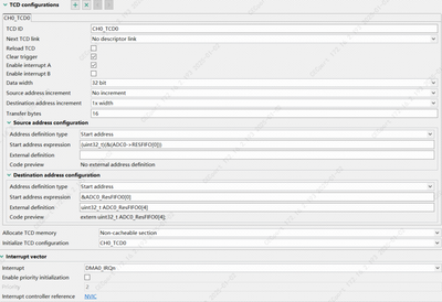

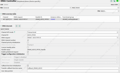

    3.2>For DMA, enable ADC0 request and transfer the data to SRAM
    4>Question
        DMA can't generat the interrupt, and I am not sure whether ADC0 FIFO0 Watermark event request the DMA.
    Thanks.

Hello @jimmyli
Thank you for your interest in NXP Semiconductors.
Question "I am not sure whether the ADC0 FIFO0 Watermark event requests the DMA."
-> I recommend that you first check whether the DMA has transferred data to the SRAM.
https://community.nxp.com/t5/LPC-Microcontrollers/Using-Configtools-to-set-up-ADC-and-DMA-from-scrat...
https://community.nxp.com/t5/LPC-Microcontrollers-Knowledge/ADC-multi-channel-sampling-and-DMA-trans...
For ADC + DMA, there are two threads that you can refer to. They all use the config tool developed.
Alice
