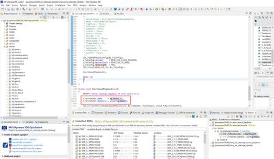

As you said that "We are converting the text to audio(.mp3 /.wav), 2. (.mp3 / .wav) Converting into Bin file using audacity tool", pls check the PCM format, especially, the data length. For example, each PCM sample consists of two bytes or 3 bytes.
If you use two bytes, you have to set
I2S_TxGetDefaultConfig(&s_TxConfig);
s_TxConfig.divider = DEMO_I2S_CLOCK_DIVIDER;
s_TxConfig.masterSlave = DEMO_I2S_TX_MODE;
s_TxConfig.dataLength = 16U;
If you use three Bytes, you have to set:
s_TxConfig.dataLength = 24U;
BTW, I suggest you use example interrupt_transfer example, in the example, it plays the PCM
array g_Music[], which is defined in music.h, one sample consists of two bytes.
First of all, play the music defined in the g_Music[], then replace the music.h with your own PCM,  check if the data length in PCM array matches with the s_TxConfig.dataLength.
Hope it can help you
XiangJun Rong

xiangjun_rong
Pls download SDK package for the LPC55S69-EVK board from the link:
https://mcuxpresso.nxp.com/en
This is the codec configuration:
wm8904_config_t wm8904Config = {
.i2cConfig = {.codecI2CInstance = BOARD_CODEC_I2C_INSTANCE, .codecI2CSourceClock = BOARD_CODEC_I2C_CLOCK_FREQ},
.recordSource = kWM8904_RecordSourceLineInput,
.recordChannelLeft = kWM8904_RecordChannelLeft2,
.recordChannelRight = kWM8904_RecordChannelRight2,
.playSource = kWM8904_PlaySourceDAC,
.slaveAddress = WM8904_I2C_ADDRESS,
.protocol = kWM8904_ProtocolI2S,
.format = {.sampleRate = kWM8904_SampleRate48kHz, .bitWidth = kWM8904_BitWidth16},
.mclk_HZ = DEMO_I2S_MASTER_CLOCK_FREQUENCY,
.master = false,
codec_config_t boardCodecConfig = {.codecDevType = kCODEC_WM8904, .codecDevConfig = &wm8904Config};
The codec is a slave, it's MCLK is from LPC55S69, it's bit clock and frame clock are from LPC55S69.
The data format is 16 bits for each slot and the baudrate is 48KHz.
XiangJun Rong
