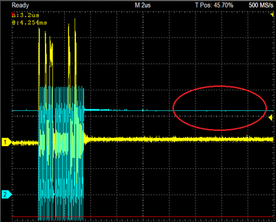

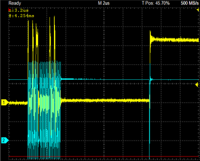

After checking the waveform, we found that it gets stuck at GETMRL. After reading the MRL LSB, the SCL line stops and doesn't move anymore.
In previous case, I3C_BusMasterGetBCR reads the BCR value of the ICM42688P as 39 (= b00100111), which indicates that it supports BCR[2] IBI Payload. As a result, The dataSize of GETMRL in I3C_BusMasterGetMaxReadLength is 3.
If we assume that it does not support BCR[2] IBI Payload, that is, do not call I3C_BusMasterGetBCR, then the dataSize of GETMRL in I3C_BusMasterGetMaxReadLength is 2.

Then we can see GETMRL workable, it no longer gets stuck.

I test LSM6DST which is an another sensor that supports GETMRL 3 bytes. The original I3C driver doesn't lock.
In comparison, ICM42688P pulls low the T-bit of LSB byte to indicate the end of the data. It means that if the sensor doesn't support GETMRL 3 bytes and the original driver want to read 3 bytes, then it will be locked.
I think the best is: The GETMRL function returns fail/error status if the driver want to read 3 bytes and the sensor doesn't support 3 bytes (pull low the T-bit of LSB byte).
However, it is acceptable: The GETMRL function will not lock at least.

Thanks. I tested IDE v24.12.148 & SDK 25.03.00. The GETMRL no longer get stuck.
