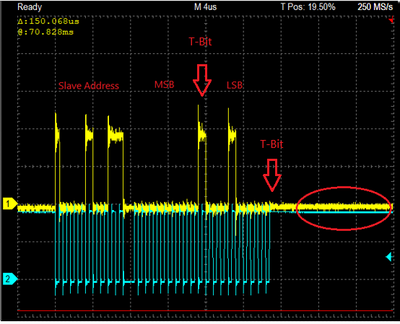

I'm running I3C on LPC5536-EVK and find out that GETMRL command doesn't seem to work for any of the sensors. This issue can be reproduced in Building an I3C Sensor Network Using LPC553x/LPC55S3x example.
To begin with the conclusion: if GETMRL reads 3 bytes, it gets stuck after reading two bytes. However, if GETMRL reads only 2 bytes, it does not get stuck.
SDK: SDK_2.16.000_LPCXpresso55S36
At the beginning, if we call the I3C_BusMasterGetDeviceInfo() function from fsl_component_i3c.h, the function will get stuck. The I3C_BusMasterGetDeviceInfo() function includes several commands, such as GETPID, GETBCR, GETDCR, GETMRL, and GETMWL.
To simplify things, we copied out the two functions I3C_BusMasterGetBCR (GETBCR) and I3C_BusMasterGetMaxReadLength (GETMRL) and tested them individually.

Then we can reproduce the stuck issue by calling them:
i3c_device_information_t device_info;
memset(&device_info, 0, sizeof(device_info));
device_info.dynamicAddr = icm42688p_sensorAddr;
I3C_BusMasterGetBCR(&demo_masterDev, &device_info);
I3C_BusMasterGetMaxReadLength(&demo_masterDev, &device_info);

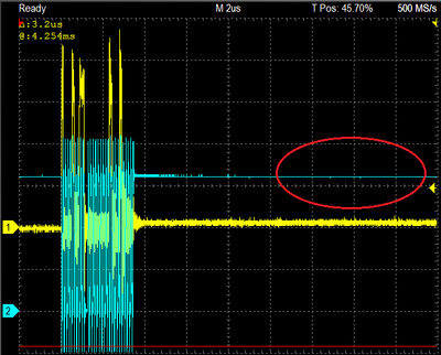

After checking the waveform, we found that it gets stuck at GETMRL. After reading the MRL LSB, the SCL line stops and doesn't move anymore.
In previous case, I3C_BusMasterGetBCR reads the BCR value of the ICM42688P as 39 (= b00100111), which indicates that it supports BCR[2] IBI Payload. As a result, The dataSize of GETMRL in I3C_BusMasterGetMaxReadLength is 3.

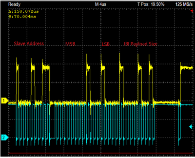

If we assume that it does not support BCR[2] IBI Payload, that is, do not call I3C_BusMasterGetBCR, then the dataSize of GETMRL in I3C_BusMasterGetMaxReadLength is 2.
//I3C_BusMasterGetBCR(&demo_masterDev, &device_info);
Then we can see GETMRL workable, it no longer gets stuck.
In MIPI I3C Basic℠ v1.1.1 , 5.1.9.3.6 Set/Get Max Read Length (SETMRL/GETMRL), the 3rd byte is IBI Payload Size which is optional. That is, if the sensor support IBI Payload, GETMRL shall read 3 bytes. But in current SDK, it seems get stuck if we read 3 bytes.

I test LSM6DST which is an another sensor that supports GETMRL 3 bytes. The original I3C driver doesn't lock.
In comparison, ICM42688P pulls low the T-bit of LSB byte to indicate the end of the data. It means that if the sensor doesn't support GETMRL 3 bytes and the original driver want to read 3 bytes, then it will be locked.
I think the best is: The GETMRL function returns fail/error status if the driver want to read 3 bytes and the sensor doesn't support 3 bytes (pull low the T-bit of LSB byte).
However, it is acceptable: The GETMRL function will not lock at least.
