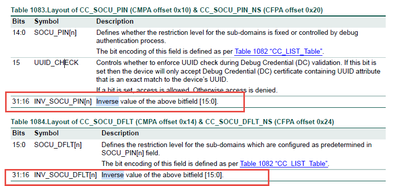

3) I even tried setting DBGEN PIN & DFLT to 1 but I couldn't generate the CMPA as the tool wouldn't allow the generation.
Gary
11,323 Views
Hello @GaryLPC
From you cmpa.bin and cfpa.bin, not enabled Debug authenticaiton.
Pay attention, for the CC_SOCU_PIN and CC_SOCU_DFLT of cmpa and cfpa,  31:16 bits are inverse valule of 15:0 , detail refer to UM11126  as below:
In your cmpa&cfpa, they are all "0".
I attached a example for lpc55s69, the same with lpc55s28, it includes all the files you can refer to.
Pay attention, when you change cmpa and cfpa, please in one cycle, I mean, after finished all the changes, then reset, do not reset in middle. And the CFPA update mechanism checks the value of version at each update. The new version must be higher than the previous one
Alice

GaryLPC
Hi @Alice_Yang ,
Yes I've found that issue, this is because the generation commands in the documentation you pointed to is wrong and is missing an argument to enable the inverted values.
Now with the updated cmpa/cfpa I can communicate to the DAP, however it is still impossible to properly authenticate, it gives the following output:
