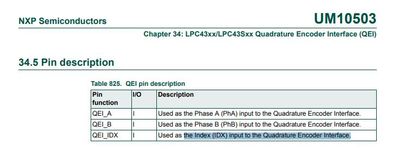

Hello, I am working on calculating the Motor Revolutions. As part of that, I found that in the register in Quadrature Encoder Interface, there is a register "INXCNT" in QEI, which will provide me with the revolution counting.
1. "When I tried to read the INXCNT register value in QEI after performing a few revolutions, I see the value as "0xFFFFFFFF". Using the "CON" register I cleared the index counter by setting the bit 3 of the ‘CON’ register to 1. Even after that, for the first revolution itself, "INXCNT" is set to "0xFFFFFFFF". For the second time, I tried to rotate the motor manually in the opposite direction. Then the value is set to "0x00000001" and then when normal rotations were performed it is set back to "0x00000000" and never got incremented. The encoder has Index, PhaseA, and PhaseB signals but not home signals. Can you please let me the behavior of the "INXCNT" register of QEI? (INXCNT should be counting the number of revolutions)”.
2. "Second issue I see is, in the documentation (UM10503, LPC43xx_LPC43Sxx User manual), the definitions of both the "POS" register and the "INXCNT" register were the same. May I know the difference between both registers? "

In the documentation (UM10503, LPC43xx_LPC43Sxx User manual), it is mentioned that "QEI_IDX is used as the Index (IDX) input to the Quadrature Encoder Interface".
But you have mentioned INXCNT is not related to QEI_IDX signal. If so, how can I calculate total revolutions by using rising and falling edge number of both PHA and PHB. Because clearly in our registers, INXCNT is not updating accordingly.
My requirement is to get the total revolutions after the motor spins. Do I need to have any special configurations to make INXCNT register to update to total revolutions?

As the following Fig, the Index Counter is connected to Inx_pulse, dir and clk_pulse, it does not says that the Index Counter is just connected to Inx_pulse.
Assume that the rotor rotates 1000 revolution in clockwise, then it rotates in 500 revolution in anti-clockwise, if the INXCNT just counts the INDEX pulse, it will get 1500 revolution, obviously, it is wrong, because the final revolution is 1000-500=500.
The INXCNT counts the rising/falling edges number of both PHA and PHB in increasing direction in clockwise rotation,  for example one revolution covers 1024 PHA pulse, the  INXCNT will be 1000*1024*4, INXCNT=40960000
After 500 revolution in anti-clockwise, the INXCNT will counts the rising/falling edges number of both PHA and PHB in decreasing direction, the INXCNT will be 40960000-500*1024*4=20480000
You can get the final revolution by 2048/(1024*4)=500 revolution.
Note the PHA and PHB signal relative phase includes the rotation direction information.
