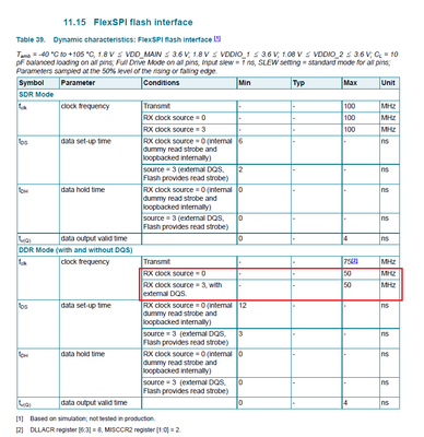

According to the LPC55S36 data sheet.
The maximum frequency of the clock is 50M(DDR MODE).
    /* Flexspi frequency 150MHz / 3 = 50MHz */
    CLOCK_SetClkDiv(kCLOCK_DivFlexSpiClk, 0U, true);  /*!< Reset FLEXSPICLKDIV divider counter and halt it */
    CLOCK_SetClkDiv(kCLOCK_DivFlexSpiClk, 3U, false); /*!< Set FLEXSPICLKDIV divider to value 3 */
    CLOCK_AttachClk(kPLL0_to_FLEXSPI);                /*!< Switch FLEXSPI to PLL0 */
Harry

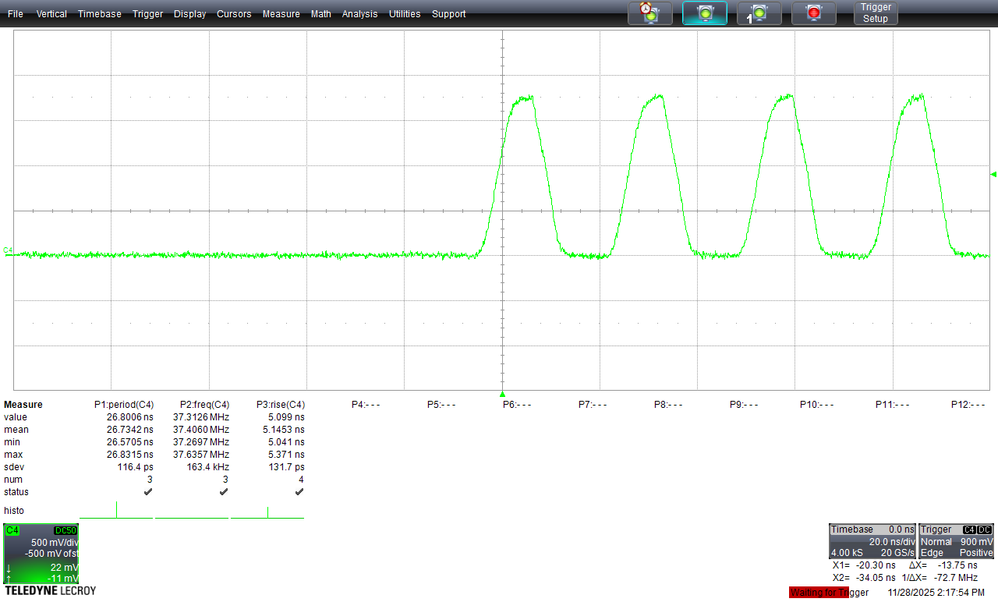

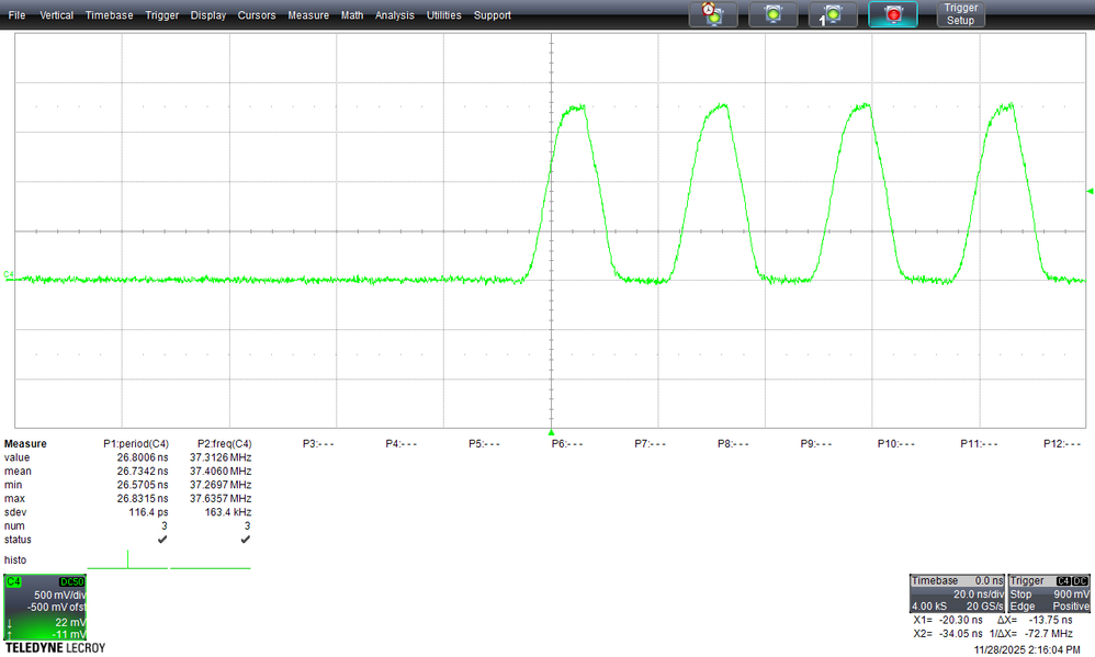

I tried to see if there were any differences between my LUT and the one used by the user in the other post you linked but even after trying to adjust the number of dummy in the latency wait state I am still having the same issue.
I don't know if I have misconfigured something on my IDE installation but it seems that on LPC5536 I can not set differential clock from the  flexspi_config_t data structure (field enableSckBDiffOpt is inside a disabled ifdef).

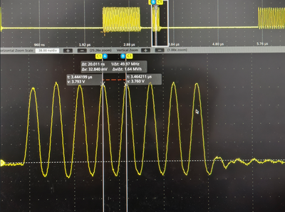

We took some measures on the board. The CSN and CLK signal are active.
We captured the clock with two options of slew rate (standard and high)
The clock frequency is slower than I expected it to be (I think that I have set it to 75MHz and here I have 75/2 instead of 150/2).
The data and RWDS signals are stable at 0V. We just see a little glitch (5ns) on the data signals
I am also attaching the pin_mux and clock_config files that are output from the graphical user interface.
Do you have any other suggestions please?

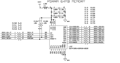

Harry_Zhang
Hi @img_gabrigob
Can you share the schematic connection to HyperRAM?
Harry
4,536件の閲覧回数
img_gabrigob
Hello!
Thanks for the reply

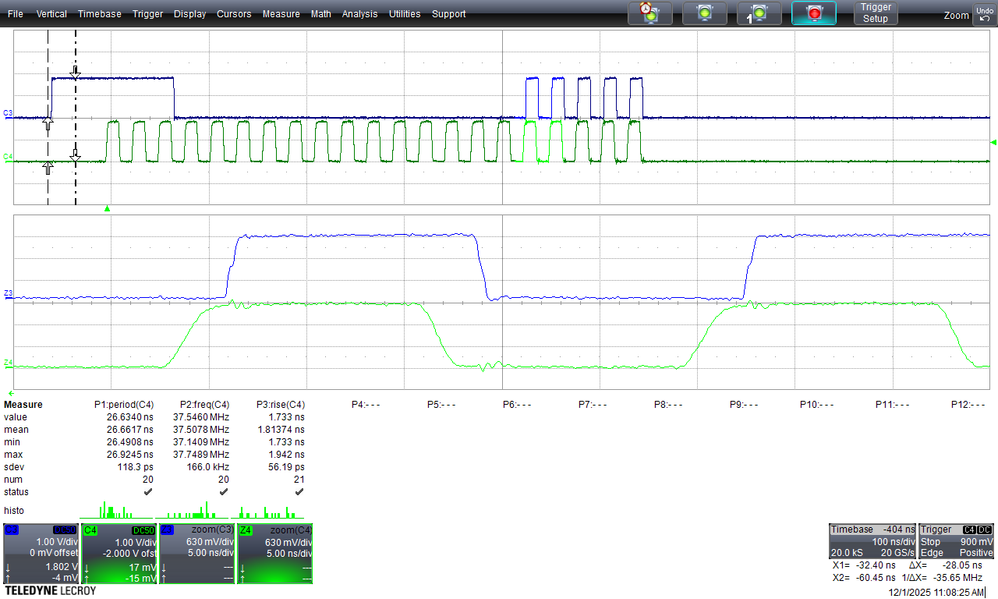

I have checked again the schematic and... I realised that RESN is not controlled by the FLEXspi so I changed the software and made it rise.
Now the controller works, we also configured the pins on the MCU to be with Fast Slew Rate option.
This is the RWDS versus CLK , for example.
So the problems were the values for latency in LUTs (corrected with your link) and the reset.

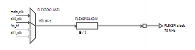

There's still something I am not understanding even if this is not fundamental for this project but may be useful for future applications: from the configuration in the clock tree I would expect CLK to be at 75MHz but I measured 37.5
Is there any other clock divider I missed?
best regards,
Gabriele

Hi @img_gabrigob
Harry

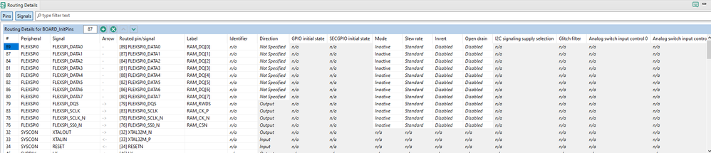

Harry_Zhang
Hi @img_gabrigob
About the pin config.
Did you just configure 5 data pins ?
S27KS0642GABHV020 requires an 8 data pins.
