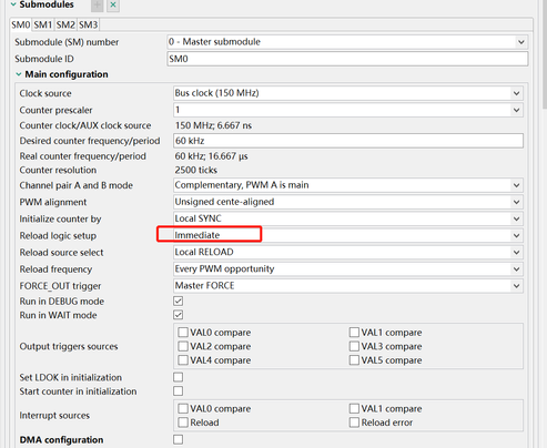

      We are developing a project by LPC3336, a question shown below.
      Hope you can help to check and fix.
     1>LPC5536 PMW0 SM0 configuration
      2>Question
           "Immediate"  can't take effect soon when set LDOK ( LDMOD is set to 1), we can't find the reason.
      Thanks very much.

Hello @jimmyli
1) Please check register SM0CTRL, whether set LDMOD to 1.
2)Test with SDK demo "PWM", default  configuration is
/* Use full cycle reload */
pwmConfig.reloadLogic = kPWM_ReloadPwmFullCycle;
change it to " kPWM_ReloadImmediate", check whether  "Immediate"   take effect, also can compare the difference between two configurations.
Alice

明省徐
Hi, Alice_Yang:
    I Test with SDK demo "PWM", default  configuration,change reloadLogic to kPWM_ReloadImmediate.
/* Use kPWM_ReloadImmediate reload */
pwmConfig.reloadLogic = kPWM_ReloadImmediate;
And check  LDMOD is 1.
But when i change pwm duty, the duty is not change Immediate.
My test code  is as follows:(pwm frequent is 10khz)
