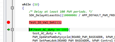

明省徐
Hi, Alice_Yang:
    I Test with SDK demo "PWM", default  configuration,change reloadLogic to kPWM_ReloadImmediate.
/* Use kPWM_ReloadImmediate reload */
pwmConfig.reloadLogic = kPWM_ReloadImmediate;
And check  LDMOD is 1.
But when i change pwm duty, the duty is not change Immediate.
My test code  is as follows:(pwm frequent is 10khz)
破坏者
Config change:
/* PWM A & PWM B form a complementary PWM pair */
pwmConfig.pairOperation = kPWM_ComplementaryPwmA;
pwmConfig.enableDebugMode = true;
infinite loop:
while (1U)
    /* Delay at least 100 PWM periods. */
    SDK_DelayAtLeastUs((1000000U / APP_DEFAULT_PWM_FREQUENCE) * 100, SDK_DEVICE_MAXIMUM_CPU_CLOCK_FREQUENCY);
    Test_IO_Val_Set(1);
    if(test_AC_duty == 100){
      test_AC_duty = 0;
      PWM_UpdatePwmDutycycle(BOARD_PWM_BASEADDR, kPWM_Module_0, kPWM_PwmA, kPWM_SignedCenterAligned, test_AC_duty);
      PWM_SetPwmLdok(BOARD_PWM_BASEADDR, kPWM_Control_Module_0, true);
    else{
      test_AC_duty = 100;
    Test_IO_Val_Set(0);
