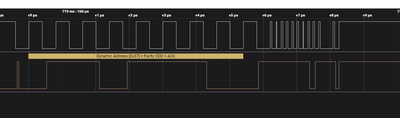

Hi everyone!
I'm working on an I3C driver for LPC5536 MCU for a client. Until now, I am working on  Master SDR support, and Private Read, Private Write, CCC commands, and I2C over I3C are already implemented and running perfectly.
The problem is that ENTDAA is not working well. After the first dynamic address is assigned to the first target, the R-START condition is not performed correctly and is not recognized by the rest of the targets. Attached is a picture.
I found another post here (https://community.nxp.com/t5/i-MX-Processors/I3C-ENTDAA-Repeated-start-waveform/m-p/1387045). I copyed the timing characteristics  (Ton for PP, etc, etc) but the problem is still present. I tried enabling ODHPP, disabling ODHPP, respecting 200 ns for Open-Drain Ton period, but nothing solve the problem.
In my case, the I3C Clk Freq is 50 MHz, after dividing the main clock 150 MHz by 3.
Do you have any suggestion??

martingcavallo
I share my last tests...
  • I kept I3C FCLK 50 MHz
  • I kept PPBAU = 1
  • I changed ODHPP to 0.
  • I tested OD SCL Frequency to 1.25 MHz and 2.5 MHz to ensure that the First I3C Boradcast Address 0x7E Open Drain timing contrains are satisfied (both SCL Low Period and SCL High Period greater than 200 ns)
In these cases the Boradcast 0x7E is ACKed, (Broadcast ENEC and Broadcast RSTDAA are performed first), so ENTDAA starts correctly, the first target sends PID, BCR and DCR, the controller assigns a dynamic address but fails in the R-START pattern.
Attached are these two captures plus the one I sent above. I changed the names to identify each case. The captures sample rate is 100 Mb/s, generated with Saleae Logic 2.
Please let me know if you need further information.
BR,
Martin
11,062件の閲覧回数
martingcavallo
Well... I did one more test. I kept FCLK in 50 MHz and incremented PPBAUD from 1 to 2 so now the SCL T high is greater than 50 ns. However the 0x7E is NACKed yet, while SCL T high is 70 ns.
Attached is the capture I shared in the last reply and the new one that shows what I'm reporting here.
Martin
11,088件の閲覧回数

martingcavallo
Hi xiangjun_rong, thanks for your response.
I ran the SDK example as you asked. But I didn´t get a good result. Most of the time, the example starts the ENTDAA correctly but it gets halted after sending the dynamic address. Attached is a capture from Saleae Logic that shows this.
One thing I did was read/get MCONFIG register to analyze the peripheral configuration.
The details are:
  • MCU Clock set to 150 MHz.
  • I3C Clock set to 37.4 (I3C Clock divider set to 4)
  • PPBAUD = 1       ( So Push-Pull SCL T high = 53.33 ns)
  • PPLOW = 0         ( So Push-Pull SCL Frequency is 9.375 MHz)
  • ODHPP = 1         ( So Open-Drain SCL T high = Push-Pull SCL T high)
  • ODBAUD = 3      ( So Open-Drain SCL Frequency is 3.75 MHz)
  • HKEEP = 0
  • ODSTOP = 0
  • SKEW = 0
I tryed to follow a similar configuration:
  • I3C Clock set to 50 MHz (I3C Clock divider set to 3)
  • PPBAUD = 1 to get  Push-Pull SCL High 40 ns.
  • PPLOW takes the values:
    Fclk [MHz]50
    PPBAUD1
    PPLOWSCL(MHz)
    0,012,50000
    1,010,00000
    4,06,25000
    6,05,00000
    12,03,12500
  • ODHPP = 1         ( So Open-Drain SCL T high = Push-Pull SCL T high) Keep the example config here.
  • ODBAUD = 6      ( So Open-Drain SCL Frequency is 3.125 MHz)
  • HKEEP = 0
  • ODSTOP = 0
  • SKEW = 0
As result, in my case the first I3C Broadcast Address 0x7E is NACKed. There is a Salae Logic attached too.
Some observations here:
  1. I understand that the first I3C Broadcast Address should be performed in Open-Drain. This seems to occur in my project, however seems like in the SDK example the first 0x7E is performed in push-pull because the SCL frequency is closer to Push-Pull frequency than the Open-Drain frequency. 10 MHz is too high for Open-Drive or unless is not allowed in I3C MIPI specification. Refer to Table 86 I3C Open Drain Timing Parameters on MIPI I3C Basic V1.1.1 specification. However, it seems to work because the 0x7E was ACKed.
  2. The fact that the first 0x7E is NACKed in my case, might be due to a short SCL T high equal to 40 ns. Could be possible that an I3C target that has no dynamic address assigned might have the 50 ns spike filter activated so it doesn't detect the I3C traffic. In the SDK example the SCL T high is equal to 60 ns which is greater than 50 ns. However the Table 86 I3C Open Drain Timing Parameters on MIPI I3C Basic V1.1.1 specification, indicates that in Open-Drain minimum High Period of SCL is should be 200 ns for this purpose.
  3. The Table 86 I3C Open Drain Timing Parameters on MIPI I3C Basic V1.1.1 specification, indicates that in Open-Drain minimum Low Period of SCL is always 200 ns. This is not true in the SDK example.
Regarding point number 2, I remember that I tested ODHPP = 1 and SCL T high greater that 50 ns before opening this ticket. I remember I got the 0x7E ACKed but the problem with the R-START persisted.
In this link to GSheet I wrote some combinations from the CLK configuration. You will find the SDK configuration and other possible configurations. Please see the tab called "Analysis". I'd be gratefull if you review and confirm that the calculus are correct.
Finally, I am really interested in collaborate to solve this problem. I am working with I3C since 2021 and I love it. I am working now in an important project for a client and my experience hasn't been too good working with the LPC55S36 and I3C peripheral.
Let me know if you need further information.
Looking forward for your comments.
BR,
Martin

xiangjun_rong
Hi, Marting,
I have downloaded the files with *.sal you have posted, but I do not know how to open the file.
BTW, as you know that the I3C requires ACK which is driven by receiver, so I suggest you test on the LPC5536-EVK board, do you test on the LPC5536-EVK board or your target board which has I3C master and slave?
XiangJun Rong
11,051件の閲覧回数
martingcavallo
Hi xiangjun_rong,
To open the captures I shared, you must use the Saleae Logic Software. It is free and you can download it here: https://www.saleae.com/downloads/
Respect the hardware, I am using the LPCXpresso55S36 board acting the LPC5536 MCU as master and the ICM on-board sensor as a slave together with an external IMU (also as a slave). Do you need to know the serial number or revision number?
BR,
Martin
