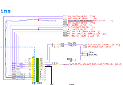

However, the value measured by ADC does not correlate with the VREF trimming except if I put a jumper cable from VREF_OUT (pin  16 @ J12) to BEMF_B/CUR_B (pin 3 @ J9).
It seems to me that this example requires an jumper cable. Is this correct?

The software select the ADC0_8A channel, which corresponds to the P0_31 pin for the LPC5536.
The P0_31 is connected to the pin3 of J9.
Of course, you can use the ADC0_3A to sample Vrefout, in the case, you can change:
#define DEMO_LPADC_USER_CHANNEL 3U
From hardware perspective, connect the Vrefout(pin16 of J12) to pin1 of J9.

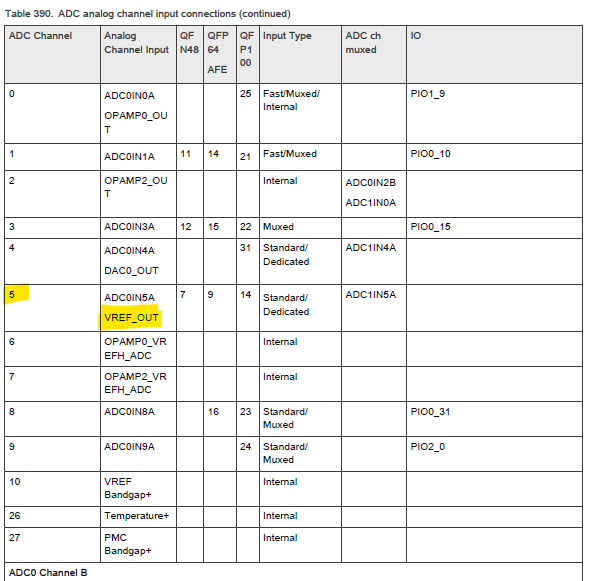

Further, we could do away with a jumper cable by setting
#define DEMO_LPADC_USER_CHANNEL 5U
as, according to the manual, ADC channel 5 is connected to VREF_OUT.
This way the example works "out of the box".
That makes a lot of sense to me. What about you?

Yes, you can use ADC0_5A channel to sample the VTEF_OUT voltage, because they are connected internally.
But the ADC example can simulate customer real environment, for example, the customer has to do the pin assignment for ADC analog channel.
XiangJun Rong
