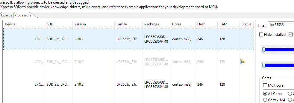

running MCUXpresso IDE 11.8.0, I downloaded and installed the plugin SDK for LPC5536. However, the version isn't 2.14.0 but the outdated 2.10.2:
Why is this?
I clicked on the "Refresh SDKs repository info" button but to no avail. Further, I checked the User Guide searching for instructions on how to update the list of plugin-SDKs but found nothing.
I must be missing something. Please advise.
Thanks.

just checked whether a "plugin" SDK for LPC5536 would be offered in:
https://mcuxpresso.nxp.com/eclipse/sdk/2.14.0/artifacts.xml.xz
but there is none. So it's no wonder the "download and install plugin SDK" wizard does not offer any.

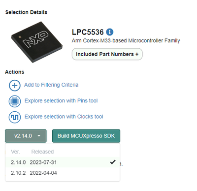

However, SDK builder provides SDK 2.14.0 for LPC5536. So I will have to resort to this classic "file system" SDK to get the recent SDK for my device.

Indeed, SDK 2.14 for that MCU was not deployed to the update site. We have an internal ticket tracking this, so it will addressed soon. You already found a workaround.
