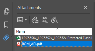

Julián_AragónM
Hi @cgerlach,
I'm sorry for the inconvenience, but that specific information is not available, as the memory space reserved is for the whole process.
For your second question, there is a file attached to the user manual called ROM_API which may be relevant to your problem, as it describes the usage and definitions of IAP APIs.
