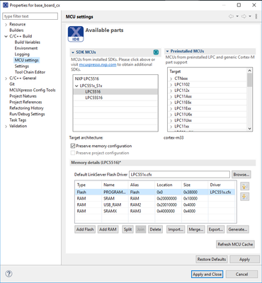

mse_videotec
Hello Alice
I have a question:
In the project settings menù of the LPC5516 we found that the size of the Flash is 0x38000 that is 224KByte instead of 244KByte.
What is the right flash dimension?
Many thanks
Mirco
