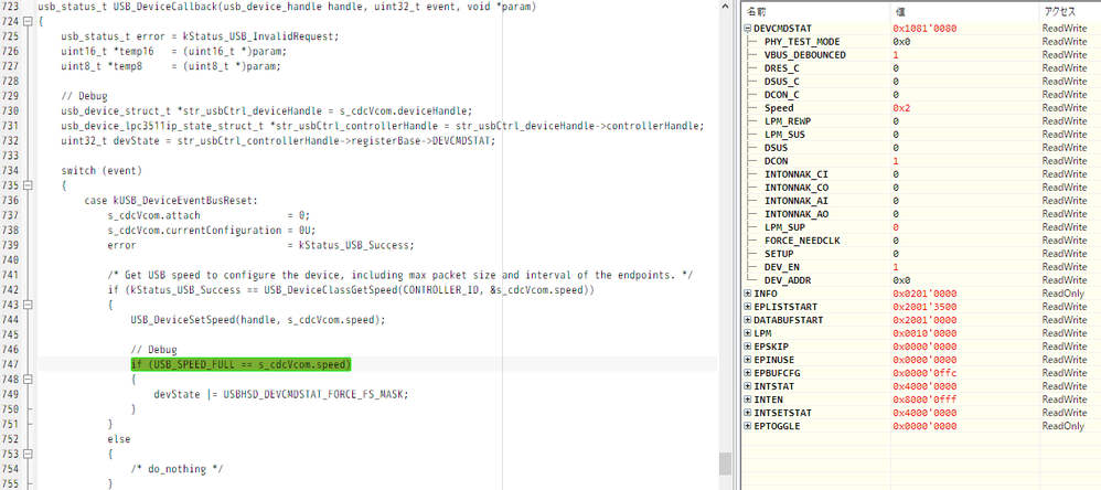

1. About USB_DeviceHsPhyChirpIssueWorkaround
Where can I find the source of "USB_DeviceHsPhyChirpIssueWorkaround()" mentioned in Work-around?
usb_dev_hid_mouse only has a declaration, no definition found.
2. About FORCE_FS
It says to set FORCE_FS(bit21), but I cannot confirm that it is set on the IDE, probably because it is not defined in the device file. Is there any way to set this bit?

Hello yamakatb,
About FORCE_FS bit, yes, there is bug with IDE, I will report it to IDE team.
Now you only can try to use register address to config and check:

Hello yamakatb,
About Q1, I will confirm with our internal, then reply you.
About Q2, how about use latest IDE and SDKv2.12? Because for old UM for lpc5514, there is no FORCE_FS(bit21), it is reserved, so there is no this bit in your IDE. Please refer to new version UM to config:
Alice

Regarding Q1, I downloaded and tried the latest IDE and SDK2.12, but the FORCE_FS bit was not present.
Regarding Q2, I was able to get and build "USB_DeviceHsPhyChirpIssueWorkaround" from usb_dev_hid_mouse in SDK2.12 for LPC54xx.
The errata says "If full-speed host is connected or "isConnectedToFsHostFlag" is set , FORCE_FS (bit 21) of DEVCMDSTAT register should be set to force the device operating in full-speed mode.
I do not recognize where FORCE_FS is set in the API.
It also says "On "kUSB_DeviceEventDetach" event, FORCE_FS (bit 21) of DEVCMDSTAT register should be cleared.
How is the FORCE_FS set and cleared being performed?

Hello yamakatb,

Referring to the errata, "If a full-speed host is connected or "isConnectedToFsHostFlag" is set, the device must be forced to operate in full-speed mode by setting FORCE_FS (bit 21) in the DEVCMDSTAT register It is stated as "The device must be forced to operate in full-speed mode.
After checking the contents of the API, we could not find where FORCE_FS (bit 21) is set.
I understand that FORCE_FS is not displayed due to an IDE error.
However, I am not sure if this can be used to work around this as I cannot see a setting to FORCE_FS in the API, which is the work-around listed in the errata.
Is it not necessary to add the FORCE_FS setting using register addresses to the API?

Hello yamakatb,
Yes, It is very necessary, I will take ticket to SDK team about this issue.
Thanks for your sharing.
