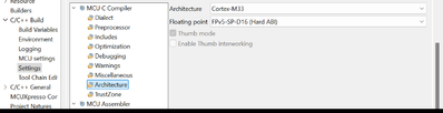

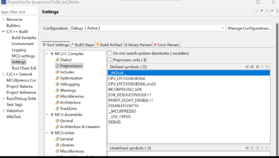

Hi @SvenAsbach
Please make sure the project defined symbols and floating point set as below:
Hope this helps,
Jun Zhang

ErichStyger
Specialist I
Usually the problem is that CR_INTEGER_PRINTF  is still defined in the -D options list.
Make sure you do a full 'clean' of the build an retry.
These are my (working) defines and Linker settings:
