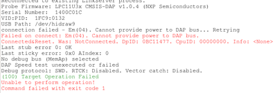

I was using the dev board just fine and was able to flash firmware without issue from mcuexpresso. Now, I get the above error when trying to flash new firmware or even just trying to perform a mass erase. The firmware I flashed just before becoming unable to interact with the board was one of the i2c examples that I had modified by a couple of lines in main. Pressing the reset button on the board doesn't help.
The P7 and P8 headers are in the correct position for SWD.

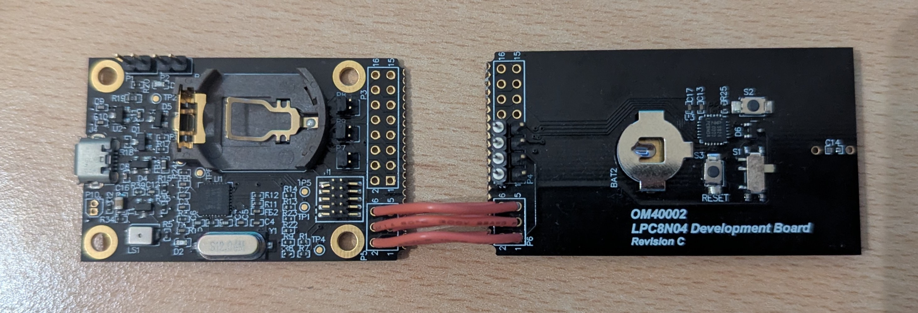

I have split the board in two and soldered wires across P6 and P5 but I have just checked all the connections with a multimeter and I don't find any shorts or disconnections.

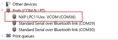

Check whether the Device Manager on your PC recognizes the board as follows:
Alice

I am using Linux but also tried this on a Windows machine to see how it shows in the device manager and noticed some interesting things. First, the device (after being flashed with new debugger firmware) does not appear in the device manager in the same way as your screenshot. Rather than showing "NXP LPC11Uxx VCOM" it just shows "USB Serial Device". I installed the windows driver for the board which was downloaded as part of the same .zip file as firmware.bin. I also installed mcuexpresso on the machine and installed the relevant SDK. After this, I restarted the Windows machine and the device still shows as "USB Serial Device". I know this is the correct device since it disappears/reappears as I unplug and replug the device.
Next, I tried to flash some example code as well as performing a mass erase from mcuexpresso on Windows. This produces the same result as on Linux: "Cannot provide power to DAP bus" but gives a little more context. After clicking on the gui flash button, it searches for debug probes and finds my device. Then it brings up a dialog that allows me to select between performing an erase or flashing some firmware I have built. After this, I get a new dialog called "SWD Configuration" which shows "0 available SWD Devices detected. Connect a device and try again". I then get the usual "Cannot provide power to DAP bus" error.
I am not sure why the "SWD Configuration" dialog only appear on Windows. I have checked the SWD header pins again and they are definitely all correctly placed to enable SWD. I have also performed another continuity test with a multimeter and found no issues. It seems that there is still something wrong.

  2. Take a photo of your board.
Thank you.

Hi @Alice_Yang Please find a video and image attached.

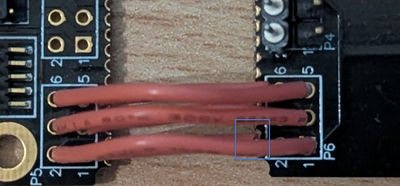

I cannot see the connection very clearly. Please connect the pins on P5 with those on P6, and do not connect them to the small pad on the left.

Apologies if the first photo wasn't clear. The wires are soldered into the holes in the board.
As far as I can tell, my wiring is the same as your diagram.
Additionally, the board was functioning correctly for quite some time with this exact wiring.
I have check for continutity/shorts by placing multimeter probes across the 10 pin debug connector to the solder points on p6 and all seems fine.

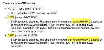

Please check what CRP value do you setting. If it is CRP2 or CRP3 as below, SWD access is disabled.
Please check the CRP value you are setting. If it is CRP2 or CRP3 as shown below, SWD access will be disabled.

I can see that the file startup_lpc8n04.c (part of the lpc8n04devboard_lpc_i2c_1_polling_transfer_master example) sets the value of the CRP to NO_CRP.
However, I can also seen in the .map file that results from building the project that the .crp section is listed under the "Discarded input sections". Running readelf on the resulting binary also shows no CRP symbol or .crp section.
While I could manually edit the linker script to ensure the section is included, it seems that the linker script is automatically generated by mcuexpresso. Is there somewhere in the IDE where I need to configure something to do with the CRP?
