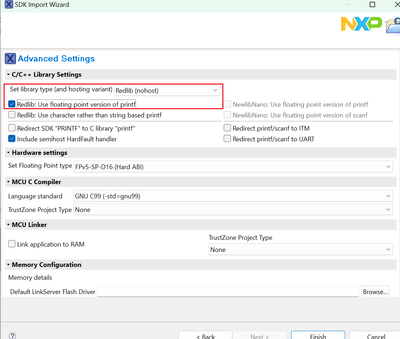

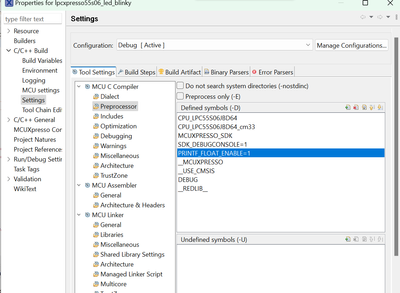

Hi @SvenAsbach
Please make sure the project defined symbols and floating point set as below:
Hope this helps,
Jun Zhang

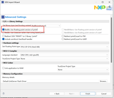

3,372 Views
ZhangJennie
Hi @SvenAsbach
If you use SDK demo, please try to enable floating support
Make sure the defined symbols, printf float is enabled.
Does this work for you?
Best Regards
Jun Zhang

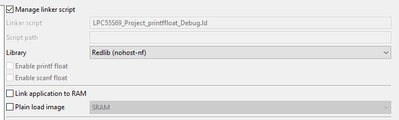

ErichStyger
Specialist I
Usually the problem is that CR_INTEGER_PRINTF  is still defined in the -D options list.
Make sure you do a full 'clean' of the build an retry.
These are my (working) defines and Linker settings:
__REDLIB__
CPU_LPC55S69JBD100
CPU_LPC55S69JBD100_cm33
CPU_LPC55S69JBD100_cm33_core0
SDK_DEBUGCONSOLE=1
PRINTF_FLOAT_ENABLE=1
SERIAL_PORT_TYPE_UART=1
__MCUXPRESSO
__USE_CMSIS
DEBUG
I hope this helps,
Erich
