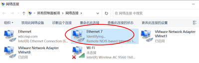

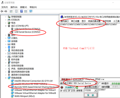

shaozhongliangs
 The attached project is a simple demonstration program based on LPC54018/SDK/usb_examples/usb_device_composite_cdc_vcom_cdc_vcom.
It is enumerated as one RNDIS network port and one virtual COM port.
This demo is to show how to build a composite USB device and to provide a
simple example for further development.
   I tested the demo on WIN10. It works fine.
IDE: KEIL
HW:LPC54018 EVK + FS USB port
