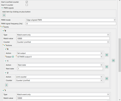

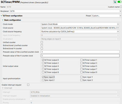

Regarding your questions, the first one, to understand better, what do you refer with "modulate the value of the duty cycle from my audio signal", because it comes to my mind that you are trying to generate a FM modulation, but I do not know if my understanding is right, by any chance do not you have a drawing or graphic where I can see what you are trying to do?
And regarding your other question, there is not an example where you can start, but one suggestion you can take in mind, is to use the peripheral tool on MCUXpresso Config Tool, where you can see an interface like this and you can configure your SCTimer as you wish and play with the different options.
