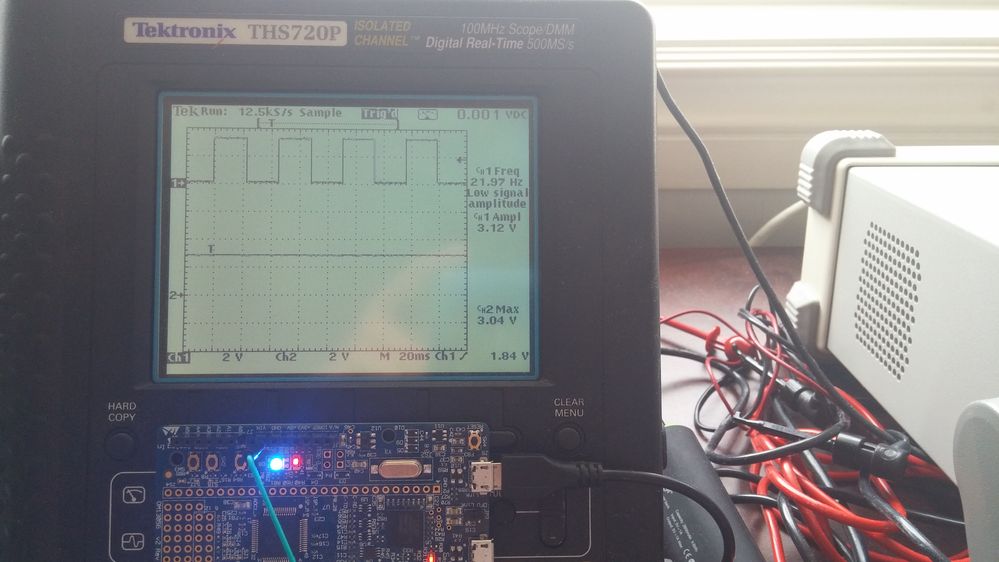

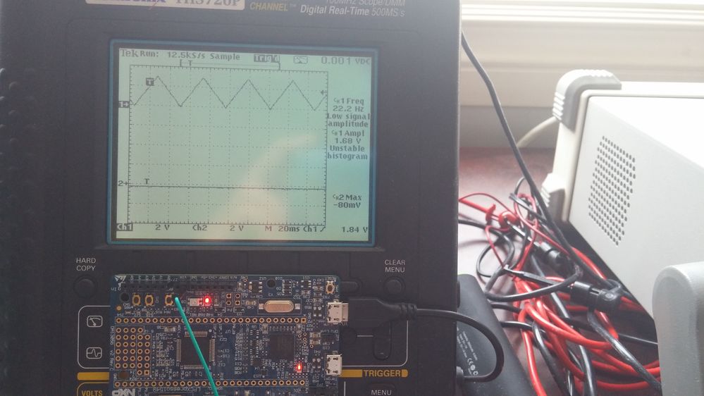

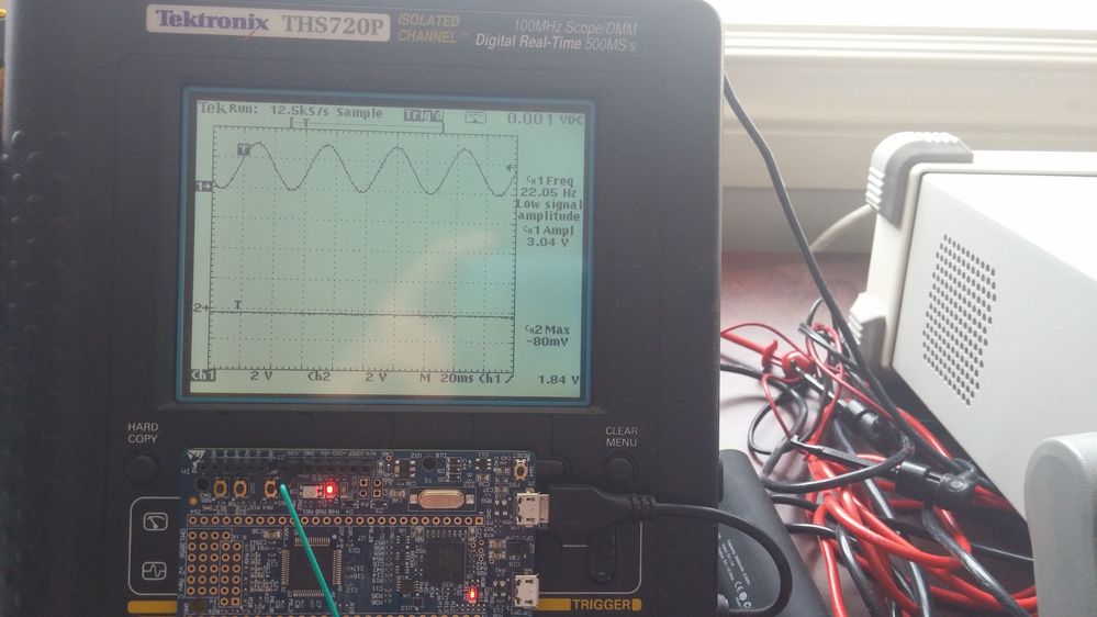

doini
Hi Kerry,
I attach pictures with 3 form waves: square, sinusoidal and ramp. The frequency for all is 22 Hz. And the amplitude is 3 V for High and 0 V for low.
In the pictures there is also the development board LPCXpresso1549 for which I wrote the code. When the signal is captured, the Blue LED must be ON, and the second channel of the oscilloscope shows the DAC output which is proportional with the input signal on channel one. You can see that for the square wave the code is running as expected, the Blue LED is ON, and there is signal on the channel 2, but for the others the Blue LED is OFF and there is not signal on channel 2.
