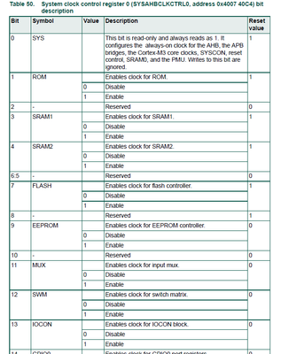

xiangjun_rong
I suppose that you do not enable the SWM and IOCON gated clock, pls set the bits 12 and 13 in SYSAHBCLKCTRL0 register with like SYSCON->SYSAHBCLKCTRL0|=1<<12|1<<13 instruction, for detailed format, pls check the register definition.
Hope it can help you
XiangJun Rong

EduardoGoncalves1966
Thank you, that made it work
