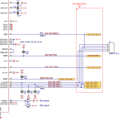

I am using the LPC54608 controller and have configured Flexcomm 5 interface for SPI communication in master mode.  The RX FIFO is emptied by the DMA controller, which is triggered for a transfer by an external pin (burst mode is enabled for a transfer of 32 bytes upon each pin interrupt).  Therefore, the "source" address for the DMA transfer is the SPI's RX FIFO.  The "destination" address of the transfer is in the EMC's address range.
For your reference, the SPI interface is connected to an external 8-channel ADC, the external pin that triggers the transfer is a data ready input for reading all channel's data (8-chan *4B/chan = 32Bytes).  For generating the SPI interface clock, and due to the data rates, we are using the Audio PLL at a frequency of 5.12 MHz.
This entire process of SPI->DMA->EMC (SDRAM) works for a period of time (ranges from 30mins to 8 hours) as configured.  Then, the SPI status register begins indicating an Rx FIFO Error, which indicates the FIFO is overflowing, and, since this is being emptied by the DMA controller, that the DMA controller is not emptying it fast enough.
Unfortunately, there's not much available regarding the status of the DMA controller itself.  I can see the triggers are still occurring, and that there are no errors for the channel (channel 10).  Nor is there any ability to increase the DMA contoller's clock (SYS clock is at 180MHz).
Can you direct me to where I can look to identify what happens, and why the FIFO is no longer getting emptied fast enough?

I am using the input pin to trigger the transfer.  The ADC we are using is   AD7770ACPZ
The 4 yellow signals at the bottom are part of the SPI interface (I can share the specific pins if needed, but they are configured correctly for SPI).  The other 4 signals are:
  1. FAST_ADC_DRDY_0 - this is the signal that goes to an input pin and is used to generate the interrupt.
  2. FAST_ADC_SYNC - this (with the reset) is an effect reset and sync to the chip.  it is used during startup.  it is a LPC54608 GPIO output
  3.  FAST_ADC_CLOCK - this is the sampling clock for the chip.  it comes from the LPC54608's CLOCKOUT that is generated from the audioPLL.  its running at 5.12MHz
  4. RESET_ADS124S08 - GPIO output that works with the sync to reset the adc chip.
The hardware triggering off the pin interrupt is configured as such:
INPUTMUX_AttachSignal( INPUTMUX, kPINT_PinInt0, kINPUTMUX_GpioPort0Pin1ToPintsel);
INPUTMUX_AttachSignal( INPUTMUX, DMA_FC5_RX_CHANNEL, kINPUTMUX_PinInt0ToDma);
INPUTMUX_AttachSignal( INPUTMUX, DMA_FC5_TX_CHANNEL, kINPUTMUX_PinInt0ToDma);
PINT_PinInterruptConfig( PINT, kPINT_PinInt0, kPINT_PinIntEnableFallEdge, NULL );
You see it is used to trigger both tx and rx.  Tx is only triggered to generate the spi clock.  The priorities are then set:
DMA_SetChannelPriority( DMA0, DMA_FC5_TX_CHANNEL, kDMA_ChannelPriority1 );
DMA_SetChannelPriority( DMA0, DMA_FC5_RX_CHANNEL, kDMA_ChannelPriority0 );
The channel configuration registers are set to use a hardware trigger:
trigger.burst = kDMA_EdgeBurstTransfer32;
trigger.type = kDMA_FallingEdgeTrigger;
trigger.wrap = kDMA_NoWrap;
DMA_SetChannelConfig( DMA0, DMA_FC5_RX_CHANNEL, &trigger, true );
DMA_SetChannelConfig( DMA0, DMA_FC5_TX_CHANNEL, &trigger, true );

xiangjun_rong
Hi, Eileen,
I have checked the hardware connection, I think it is okay.
Regarding the cause that the SPI status register begins indicating an Rx FIFO Error, which indicates the FIFO is overflowing after the DMA has worked fine for some time(several hours), I think it is difficult to track the cause.
This is another solution that you do not use FAST_ADC_DRDY_0 to trigger DMA, in the case, you do not need to modify any hardware signal connection, just modify firmware. You can use DMA request to request DMA transfer by setting the DMARX bit in FIFOCFG reg, when the SPI FIFO receive full happens, DMA will be requested automatically, this can avoid the phenomenon you faced.
Another solution is to keep current design, but you can enable the Rx FIFO Error interrupt, when the error happens, in the ISR, you can stop SPI transfer, reinitialize SPI and DMA, restart SPI and DMA.
Hope it can help you
XiangJun Rong
